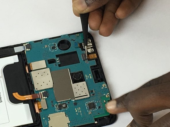

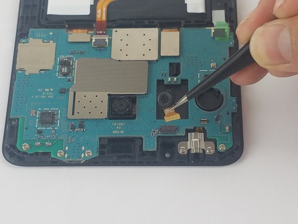

  3. Samsung Galaxy Tab A 7.0 Front Facing Camera Replacement: crwdns2935265:03crwdnd2935265:01crwdnd2935265:03crwdne2935265:0 Samsung Galaxy Tab A 7.0 Front Facing Camera Replacement: crwdns2935265:03crwdnd2935265:02crwdnd2935265:03crwdne2935265:0 Samsung Galaxy Tab A 7.0 Front Facing Camera Replacement: crwdns2935265:03crwdnd2935265:03crwdnd2935265:03crwdne2935265:0
    • Using tweezers, at the end of the gold wire, gently lift the black tab locking the wire connecting the camera to the motherboard.
    • Pull the wire from the connector, disconnecting the camera from the device entirely.
