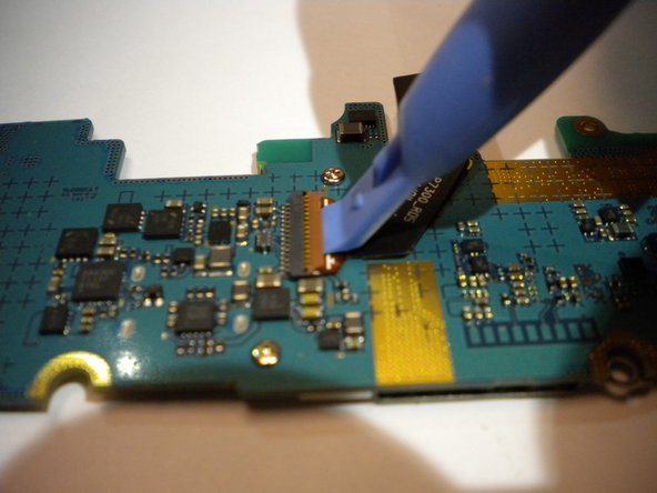

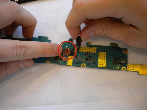

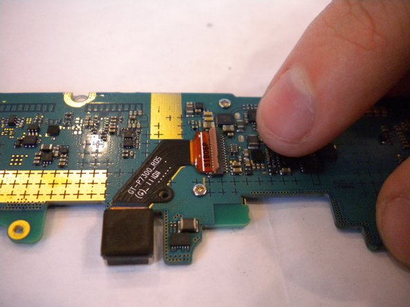

  10. Samsung Galaxy Tab 8.9 Rear Facing Camera Replacement, Locate Camera: crwdns2935265:010crwdnd2935265:01crwdnd2935265:01crwdne2935265:0
    • Camera is located in the center of motherboard.
  11. Samsung Galaxy Tab 8.9 Rear Facing Camera Replacement, Disconnect Flex Ribbon: crwdns2935265:011crwdnd2935265:01crwdnd2935265:03crwdne2935265:0 Samsung Galaxy Tab 8.9 Rear Facing Camera Replacement, Disconnect Flex Ribbon: crwdns2935265:011crwdnd2935265:02crwdnd2935265:03crwdne2935265:0 Samsung Galaxy Tab 8.9 Rear Facing Camera Replacement, Disconnect Flex Ribbon: crwdns2935265:011crwdnd2935265:03crwdnd2935265:03crwdne2935265:0
    • Using flat side of Spudger, lift orange tab connecting the flex ribbon of the camera to the motherboard.
  12. Samsung Galaxy Tab 8.9 Rear Facing Camera Replacement, Remove Camera: crwdns2935265:012crwdnd2935265:01crwdnd2935265:02crwdne2935265:0 Samsung Galaxy Tab 8.9 Rear Facing Camera Replacement, Remove Camera: crwdns2935265:012crwdnd2935265:02crwdnd2935265:02crwdne2935265:0
    • Remove the camera from the motherboard.
