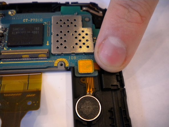

  11. Samsung Galaxy Tab 8.9 Motherboard Replacement, Motherboard: crwdns2935265:011crwdnd2935265:01crwdnd2935265:03crwdne2935265:0 Samsung Galaxy Tab 8.9 Motherboard Replacement, Motherboard: crwdns2935265:011crwdnd2935265:02crwdnd2935265:03crwdne2935265:0 Samsung Galaxy Tab 8.9 Motherboard Replacement, Motherboard: crwdns2935265:011crwdnd2935265:03crwdnd2935265:03crwdne2935265:0
    • Locate the motherboard and 5 connectors on it.
    • Pry up and detach the connector from the motherboard using the flat edge of the spudger.
    • Repeat for the 4 remaining connectors.
  12. Samsung Galaxy Tab 8.9 Motherboard Replacement: crwdns2935265:012crwdnd2935265:01crwdnd2935265:03crwdne2935265:0 Samsung Galaxy Tab 8.9 Motherboard Replacement: crwdns2935265:012crwdnd2935265:02crwdnd2935265:03crwdne2935265:0 Samsung Galaxy Tab 8.9 Motherboard Replacement: crwdns2935265:012crwdnd2935265:03crwdnd2935265:03crwdne2935265:0
    • Using the Phillips #00 screwdriver, unscrew the 3 screws (1mm) that are located near:
    • Camera
    • Power and volume buttons
    • Tilt sensor
  13. Samsung Galaxy Tab 8.9 Motherboard Replacement: crwdns2935265:013crwdnd2935265:01crwdnd2935265:03crwdne2935265:0 Samsung Galaxy Tab 8.9 Motherboard Replacement: crwdns2935265:013crwdnd2935265:02crwdnd2935265:03crwdne2935265:0 Samsung Galaxy Tab 8.9 Motherboard Replacement: crwdns2935265:013crwdnd2935265:03crwdnd2935265:03crwdne2935265:0
    • Using the flat edge of the spudger, pry and lift up the motherboard.
  14. Samsung Galaxy Tab 8.9 Motherboard Replacement: crwdns2935265:014crwdnd2935265:01crwdnd2935265:02crwdne2935265:0 Samsung Galaxy Tab 8.9 Motherboard Replacement: crwdns2935265:014crwdnd2935265:02crwdnd2935265:02crwdne2935265:0
    • Pull away the motherboard from the housing.
