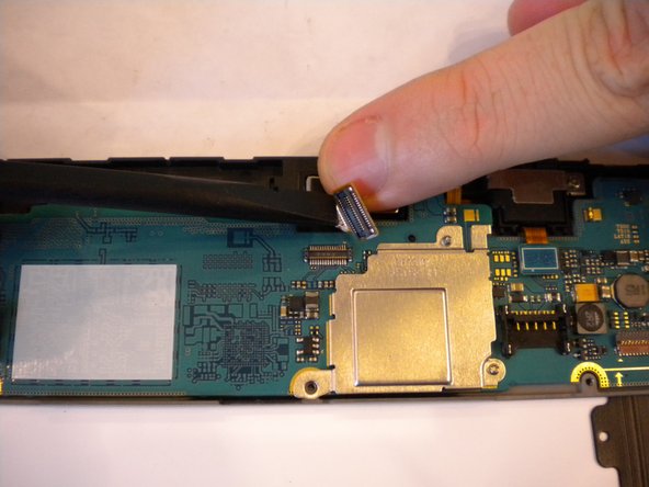

  6. Samsung Galaxy Tab 8.9 Front Facing Camera Replacement: crwdns2935265:06crwdnd2935265:01crwdnd2935265:02crwdne2935265:0 Samsung Galaxy Tab 8.9 Front Facing Camera Replacement: crwdns2935265:06crwdnd2935265:02crwdnd2935265:02crwdne2935265:0
    • Using Spudger, lift connector from mother board

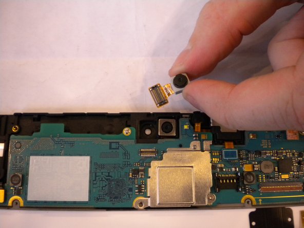

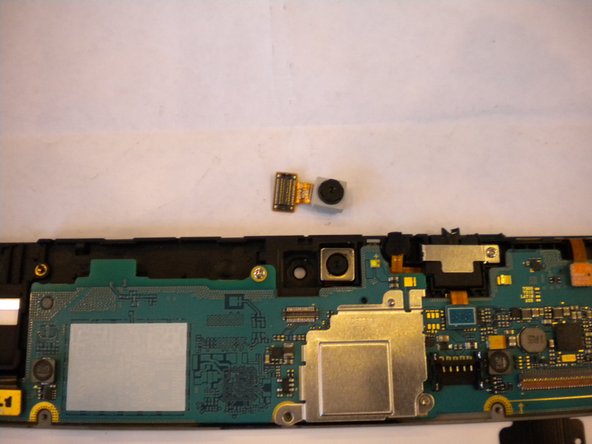

  7. Samsung Galaxy Tab 8.9 Front Facing Camera Replacement, Remove Camera: crwdns2935265:07crwdnd2935265:01crwdnd2935265:03crwdne2935265:0 Samsung Galaxy Tab 8.9 Front Facing Camera Replacement, Remove Camera: crwdns2935265:07crwdnd2935265:02crwdnd2935265:03crwdne2935265:0 Samsung Galaxy Tab 8.9 Front Facing Camera Replacement, Remove Camera: crwdns2935265:07crwdnd2935265:03crwdnd2935265:03crwdne2935265:0
    • Lift camera and remove from device.
