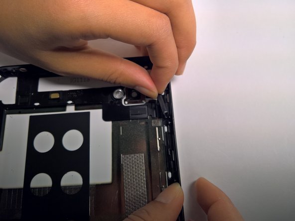

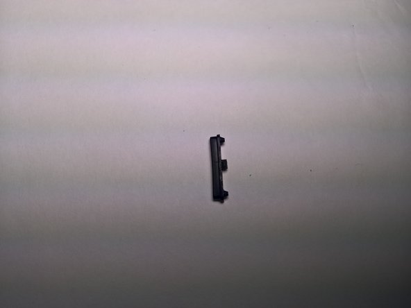

  7. Samsung Galaxy Tab 7.0 Sprint Volume Button Replacement, Volume Button: crwdns2935265:07crwdnd2935265:01crwdnd2935265:03crwdne2935265:0 Samsung Galaxy Tab 7.0 Sprint Volume Button Replacement, Volume Button: crwdns2935265:07crwdnd2935265:02crwdnd2935265:03crwdne2935265:0 Samsung Galaxy Tab 7.0 Sprint Volume Button Replacement, Volume Button: crwdns2935265:07crwdnd2935265:03crwdnd2935265:03crwdne2935265:0
    • From the outside edge of the device, carefully push the volume button inwards towards the middle of the device.
    • Make sure to not push too hard. If you push too hard, the button might slip and hit the parts on the inside close to the button.
    • Once the button is out of its slot, carefully remove it from the device.
