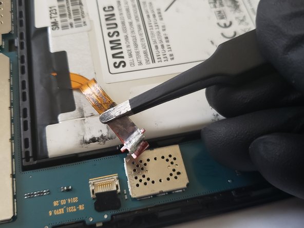

    • Using the flat end of a spudger, unclip the press fit connections below the battery and at the top near the camera.
  3. Samsung Galaxy Tab 4 7.0 Home Button Replacement: crwdns2935265:03crwdnd2935265:01crwdnd2935265:02crwdne2935265:0 Samsung Galaxy Tab 4 7.0 Home Button Replacement: crwdns2935265:03crwdnd2935265:02crwdnd2935265:02crwdne2935265:0
    • Use a plastic opening tool to pull up the locking clip of battery ZIF connector.
    • Disconnect the battery by sliding out the golden ribbon cable.

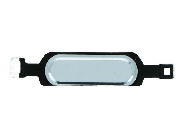

    • Carefully remove the old home button and replace with a new one.

Where can we buy the correct home button?
rayramirez - crwdns2934203:0crwdne2934203:0
I ordered one from Amazon for 8$
dpachota - crwdns2934203:0crwdne2934203:0
