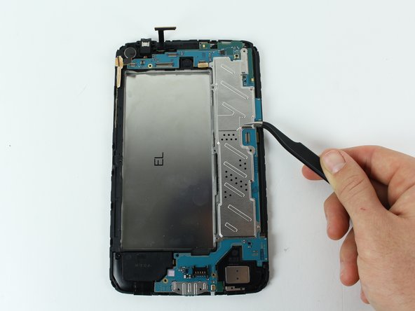

  5. Samsung Galaxy Tab 3 7.0 3G Camera Replacement, Motherboard: crwdns2935265:05crwdnd2935265:01crwdnd2935265:02crwdne2935265:0 Samsung Galaxy Tab 3 7.0 3G Camera Replacement, Motherboard: crwdns2935265:05crwdnd2935265:02crwdnd2935265:02crwdne2935265:0
    • To begin replacing mother board, remove the six flat-topped connectors shown in the first picture.
    • Remove the connections by pulling them up carefully using a spudger or tweezers, as shown in the second picture.
  6. Samsung Galaxy Tab 3 7.0 3G Camera Replacement: crwdns2935265:06crwdnd2935265:01crwdnd2935265:03crwdne2935265:0 Samsung Galaxy Tab 3 7.0 3G Camera Replacement: crwdns2935265:06crwdnd2935265:02crwdnd2935265:03crwdne2935265:0 Samsung Galaxy Tab 3 7.0 3G Camera Replacement: crwdns2935265:06crwdnd2935265:03crwdnd2935265:03crwdne2935265:0
    • First, Remove eight 1.33x2.00mm Phillip screws.
    • Once all the screws are removed, remove the motherboard using the tweezers.
    • Once the motherboard is removed, your device should look like the device in the third picture.

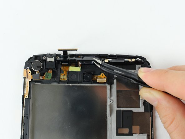

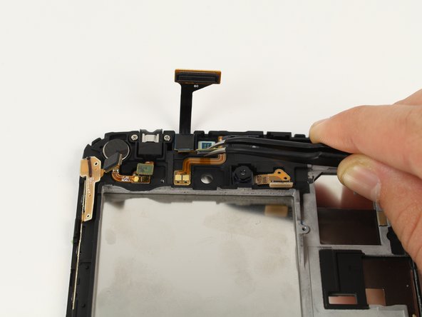

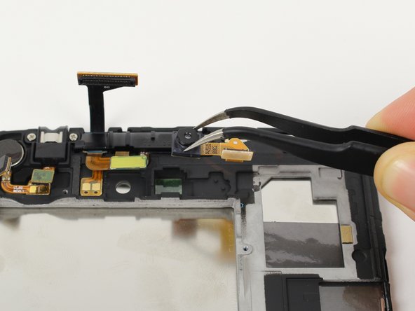

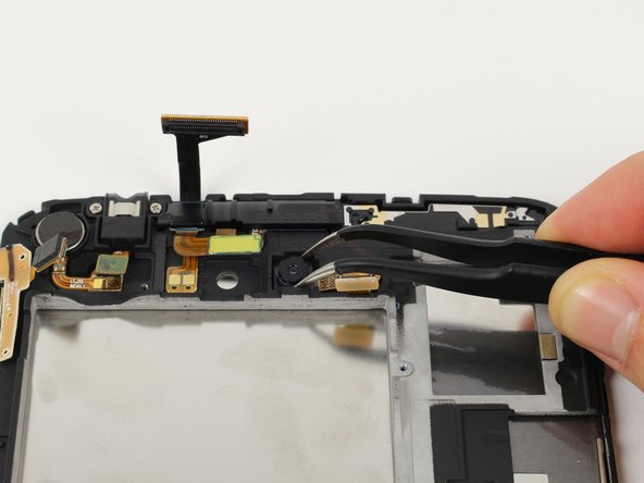

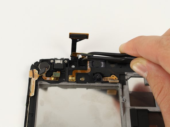

    • Begin removing the front camera by popping off the plastic stopper shown in the first picture.
    • Remove the plastic stopper with tweezers as shown in the second picture
  9. Samsung Galaxy Tab 3 7.0 3G Camera Replacement: crwdns2935265:09crwdnd2935265:01crwdnd2935265:03crwdne2935265:0 Samsung Galaxy Tab 3 7.0 3G Camera Replacement: crwdns2935265:09crwdnd2935265:02crwdnd2935265:03crwdne2935265:0 Samsung Galaxy Tab 3 7.0 3G Camera Replacement: crwdns2935265:09crwdnd2935265:03crwdnd2935265:03crwdne2935265:0
    • Once the plastic stopper is removed, use tweezers to remove the flat-topped connector for the front camera.
    • Be careful and gentle when removing the connection for the front camera. You may want to use a heat source, such as a heat gun or a blow dryer, to dissipate the glue.
    • Once the connection is unconnected, remove both the connector and the camera.
