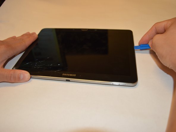

    • Turn off the power to the device before removing the back case.
    • Use a plastic tool to release the screen from the plastic case.

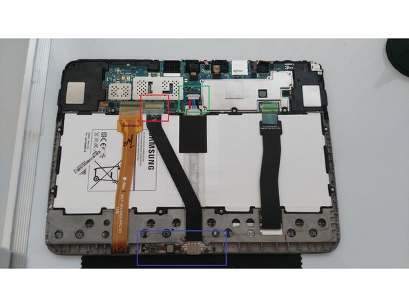

  2. Samsung Galaxy Tab 3 10.1 Charger Port Replacement: crwdns2935265:02crwdnd2935265:01crwdnd2935265:02crwdne2935265:0 Samsung Galaxy Tab 3 10.1 Charger Port Replacement: crwdns2935265:02crwdnd2935265:02crwdnd2935265:02crwdne2935265:0
    • Disconnect the battery using a spudger. Pry up gently on both sides to release the connector (marked in green).
    • Remove the tape covering the zif connector (marked in red)
  3. Samsung Galaxy Tab 3 10.1 Charger Port Replacement: crwdns2935265:03crwdnd2935265:01crwdnd2935265:01crwdne2935265:0
    • Disconnect the cable on the left of the charger (marked in green).
    • Remove the two philips screws that secure the charger port in place (marked in red).

Step 3 How do you disconnect the cable from the charge port?
