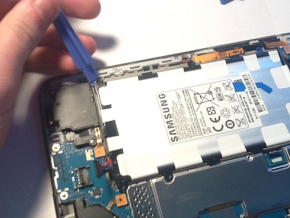

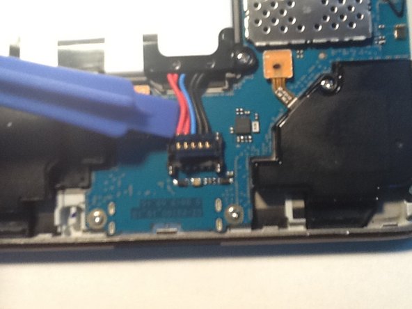

    • disconnect the battery by prying from underneath where the wires attach.
    • be careful prying. if you pry the connector you may rip it from the board.

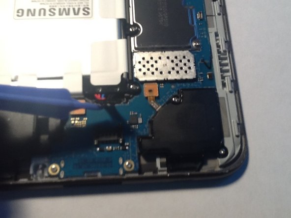

    • Next we will be disconnecting the cables shown in red
  6. Samsung Galaxy Tab 2 7.0 Digitizer Replacement: crwdns2935265:06crwdnd2935265:01crwdnd2935265:02crwdne2935265:0 Samsung Galaxy Tab 2 7.0 Digitizer Replacement: crwdns2935265:06crwdnd2935265:02crwdnd2935265:02crwdne2935265:0
    • the speaker connectors will be first.
    • Use a plastic opening tool to pop the connector off
    • repeat this for the other connectors show on previous step

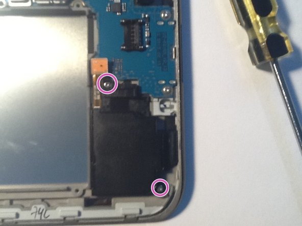

    • remove the screws holding the speakers in.

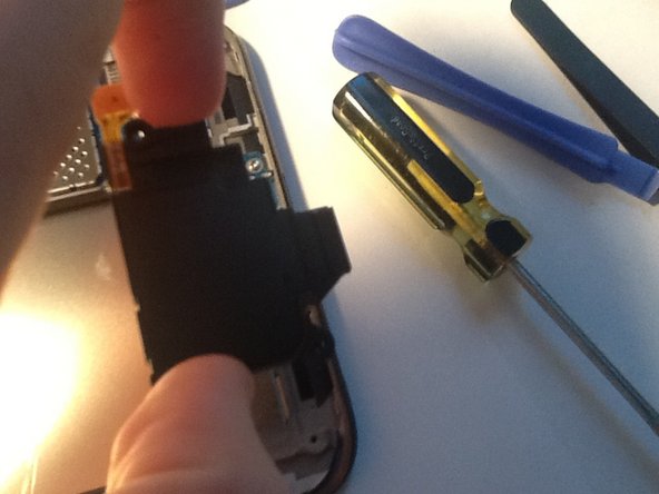

  8. Samsung Galaxy Tab 2 7.0 Digitizer Replacement: crwdns2935265:08crwdnd2935265:01crwdnd2935265:02crwdne2935265:0 Samsung Galaxy Tab 2 7.0 Digitizer Replacement: crwdns2935265:08crwdnd2935265:02crwdnd2935265:02crwdne2935265:0
    • lift both speakers out.

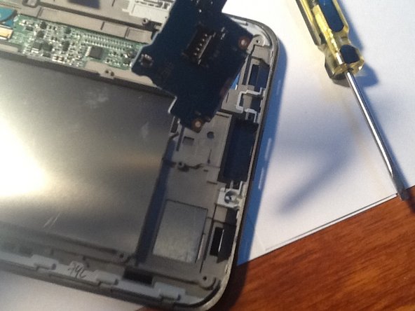

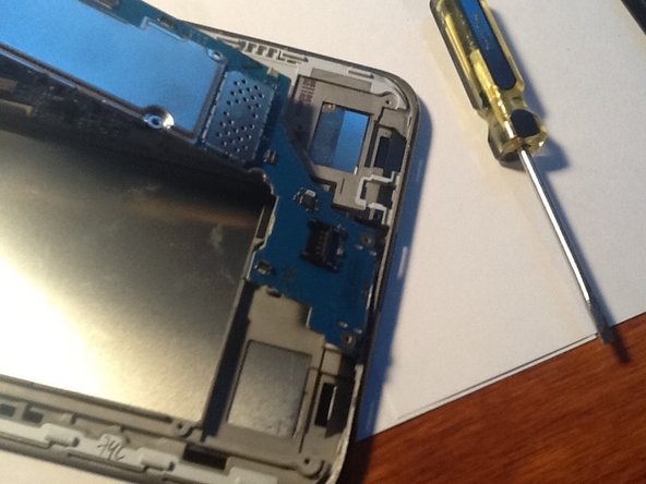

  9. Samsung Galaxy Tab 2 7.0 Digitizer Replacement: crwdns2935265:09crwdnd2935265:01crwdnd2935265:01crwdne2935265:0

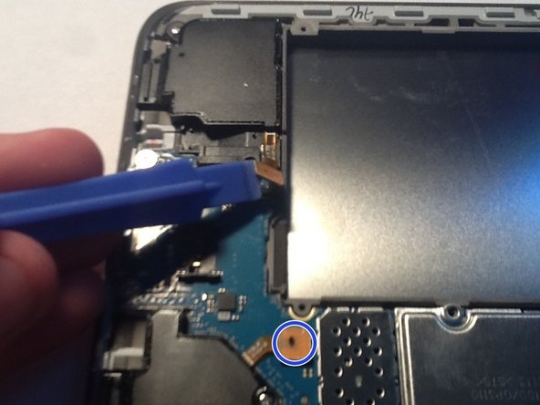

    • remove the motherboard screws as shown
  10. Samsung Galaxy Tab 2 7.0 Digitizer Replacement: crwdns2935265:010crwdnd2935265:01crwdnd2935265:03crwdne2935265:0 Samsung Galaxy Tab 2 7.0 Digitizer Replacement: crwdns2935265:010crwdnd2935265:02crwdnd2935265:03crwdne2935265:0 Samsung Galaxy Tab 2 7.0 Digitizer Replacement: crwdns2935265:010crwdnd2935265:03crwdnd2935265:03crwdne2935265:0
    • lift the motherboard out of the device

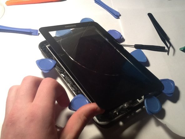

  11. Samsung Galaxy Tab 2 7.0 Digitizer Replacement: crwdns2935265:011crwdnd2935265:01crwdnd2935265:03crwdne2935265:0 Samsung Galaxy Tab 2 7.0 Digitizer Replacement: crwdns2935265:011crwdnd2935265:02crwdnd2935265:03crwdne2935265:0 Samsung Galaxy Tab 2 7.0 Digitizer Replacement: crwdns2935265:011crwdnd2935265:03crwdnd2935265:03crwdne2935265:0
    • flip it over and heat the glass using a heat gun, and insert your plastic opening tool.
    • slowly work your way around the device reheating as needed.
    • make sure the tool does not go too far into the device as it can break the lcd.
    • When heating, don't use too much heat as you can burn the lcd.

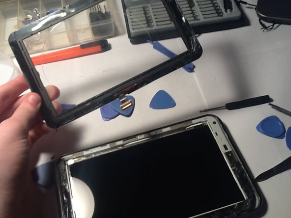

  12. Samsung Galaxy Tab 2 7.0 Digitizer Replacement: crwdns2935265:012crwdnd2935265:01crwdnd2935265:02crwdne2935265:0 Samsung Galaxy Tab 2 7.0 Digitizer Replacement: crwdns2935265:012crwdnd2935265:02crwdnd2935265:02crwdne2935265:0
    • after filling it with a world share of plastic tools, lift the screen off.
  13. Samsung Galaxy Tab 2 7.0 Digitizer Replacement: crwdns2935265:013crwdnd2935265:01crwdnd2935265:02crwdne2935265:0 Samsung Galaxy Tab 2 7.0 Digitizer Replacement: crwdns2935265:013crwdnd2935265:02crwdnd2935265:02crwdne2935265:0
    • feed the connector out of the frame.

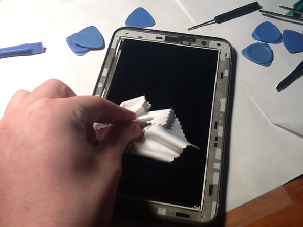

  14. Samsung Galaxy Tab 2 7.0 Digitizer Replacement: crwdns2935265:014crwdnd2935265:01crwdnd2935265:02crwdne2935265:0 Samsung Galaxy Tab 2 7.0 Digitizer Replacement: crwdns2935265:014crwdnd2935265:02crwdnd2935265:02crwdne2935265:0
    • remove the old adhesive.
    • and clean the glass off the lcd
  15. Samsung Galaxy Tab 2 7.0 Digitizer Replacement: crwdns2935265:015crwdnd2935265:01crwdnd2935265:01crwdne2935265:0
    • reapply adhesive and feed the cable in the frame.
    • Then do the whole guide in reverse minus the prying.

Just a warning, when you are taking off the old screen, trying to separate it from the glue, be careful not to insert the plastic tools too deep into the space between screen and glass, because you may damage the first one.
