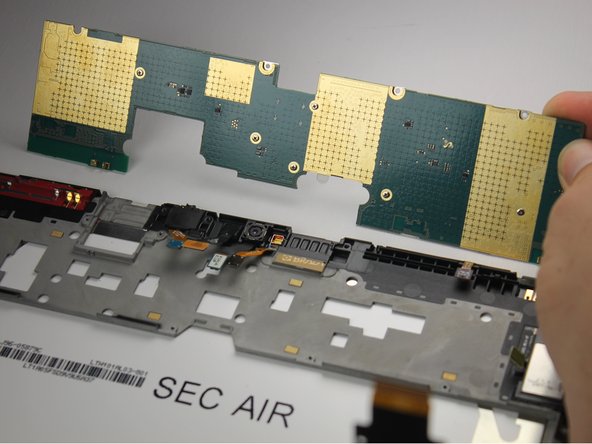

    • Lift the motherboard up and away from the device.
    • The motherboard will be easy to remove as long as all cables are disconnected. If you are having issues removing the motherboard, make sure there are no lingering connections.

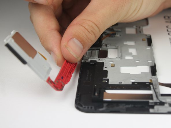

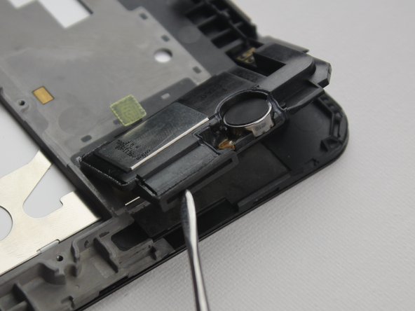

    • Using the metal spudger, pry the left speaker off of the device frame.
    • The speaker is adhered to the device frame. You will encounter resistance, so don't be alarmed if you struggle to remove the speaker.

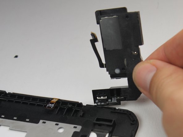

  18. Samsung Galaxy Tab 10.1 4G Speakers Replacement: crwdns2935265:018crwdnd2935265:01crwdnd2935265:02crwdne2935265:0 Samsung Galaxy Tab 10.1 4G Speakers Replacement: crwdns2935265:018crwdnd2935265:02crwdnd2935265:02crwdne2935265:0
    • When you're removing the left speaker, note how the speaker piece fits into the device frame. When rebuilding, you need to slide the speaker under the black extrusion.
    • Also remember to keep the connectors above the speaker so that they can connect to the motherboard.
  19. Samsung Galaxy Tab 10.1 4G Speakers Replacement: crwdns2935265:019crwdnd2935265:01crwdnd2935265:03crwdne2935265:0 Samsung Galaxy Tab 10.1 4G Speakers Replacement: crwdns2935265:019crwdnd2935265:02crwdnd2935265:03crwdne2935265:0 Samsung Galaxy Tab 10.1 4G Speakers Replacement: crwdns2935265:019crwdnd2935265:03crwdnd2935265:03crwdne2935265:0
    • Using the metal spudger, pry the right speaker off of the device frame in the same way.
