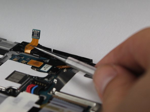

  11. Samsung Galaxy Tab 10.1 4G Headphone Jack Replacement, Headphone Jack: crwdns2935265:011crwdnd2935265:01crwdnd2935265:02crwdne2935265:0 Samsung Galaxy Tab 10.1 4G Headphone Jack Replacement, Headphone Jack: crwdns2935265:011crwdnd2935265:02crwdnd2935265:02crwdne2935265:0
    • Using a plastic spudger, gently lift the connector off of the motherboard.
    • When working with electronics, it's important to choose a tool that's ESD-safe to avoid accidental damage to the device. The regular black nylon spudger or a plastic opening tool should be used whenever possible.
    • If you have removed the SIM card properly, the headphone port connector will now be the furthest left connector.
  12. Samsung Galaxy Tab 10.1 4G Headphone Jack Replacement: crwdns2935265:012crwdnd2935265:01crwdnd2935265:01crwdne2935265:0
    • Firmly tug on the connector to remove the headphone jack.
    • If necessary, use the metal spudger tool to pry the headphone jack out of it's housing -- it will be attached with some strong adhesive.
    • Don't worry about losing adhesive, your new headphone port will have new adhesive for you to apply.
