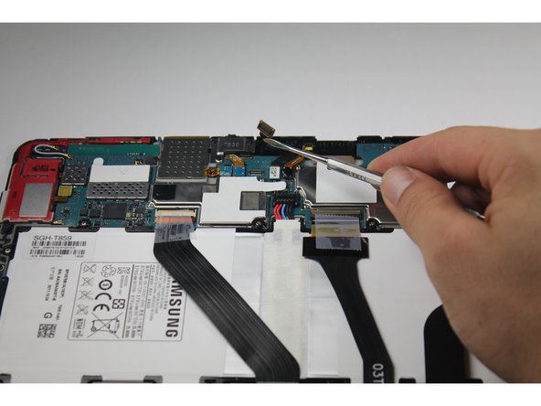

    • When working with electronics, it's important to choose a tool that's ESD-safe to avoid accidental damage to the device. The regular black nylon spudger or a plastic opening tool should be used whenever possible.
    • The connection between the battery and motherboard is a group of four wires in black housing that can be found near the top middle of the device. Using a plastic spudger or a flat, slim tool, lift the black connector housing upwards to disconnect it.
  7. Samsung Galaxy Tab 10.1 4G Front Facing Camera Replacement, Front Facing Camera: crwdns2935265:07crwdnd2935265:01crwdnd2935265:02crwdne2935265:0 Samsung Galaxy Tab 10.1 4G Front Facing Camera Replacement, Front Facing Camera: crwdns2935265:07crwdnd2935265:02crwdnd2935265:02crwdne2935265:0
    • The connection you need to unfasten is the orange rectangle with the black cable coming out of it. Slide either your nail or the metal spudger under that orange connection.
    • Gently pop the connection off the motherboard.
  8. Samsung Galaxy Tab 10.1 4G Front Facing Camera Replacement: crwdns2935265:08crwdnd2935265:01crwdnd2935265:01crwdne2935265:0
    • Remove the front facing camera.
