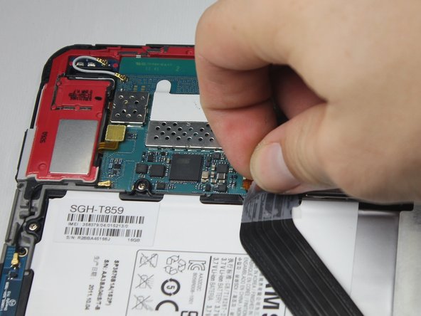

    • When working with electronics, it's important to choose a tool that's ESD-safe to avoid accidental damage to the device. The regular black nylon spudger or a plastic opening tool should be used whenever possible.
    • The connection between the battery and motherboard is a group of four wires in black housing that can be found near the top middle of the device. Using a plastic spudger or a flat, slim tool, lift the black connector housing upwards to disconnect it.

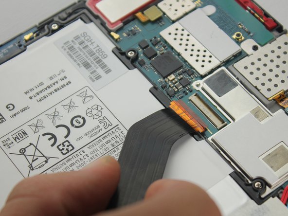

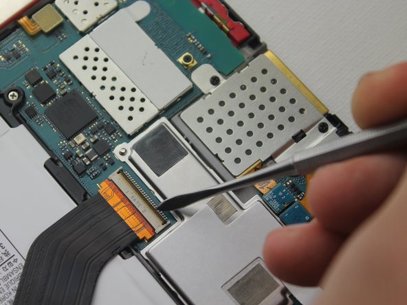

    • Slide a plastic spudger tool under the strip of black plastic on the back of the ribbon connector.
    • Metal spudgers can puncture an unprotected battery, potentially causing a fire. When working with electronics, it's important to choose a tool that's ESD-safe to avoid accidental damage to the device. The regular black nylon spudger or a plastic opening tool should be used whenever possible.
    • Gently lift with the spudger to flip the connector up. This will release the ribbon from its connection.
    • Slide the ribbon out of the connector.

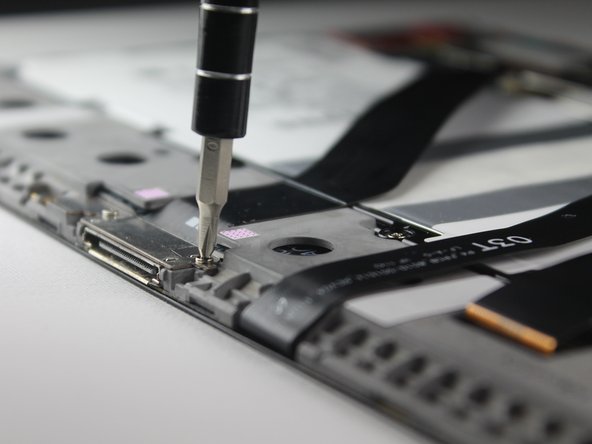

    • Use the Phillips #00 screwdriver to remove both of the 3-mm screws.

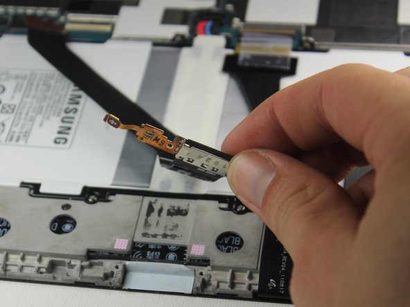

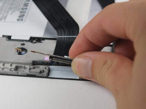

    • Slide the plastic spudger under the charge port to lift it from it's housing.
    • Pull up on the charge port to remove it and its ribbon cable.
    • You may have to pull fairly hard; the adhesive holds the bottom section of cable to the tablet tightly.
