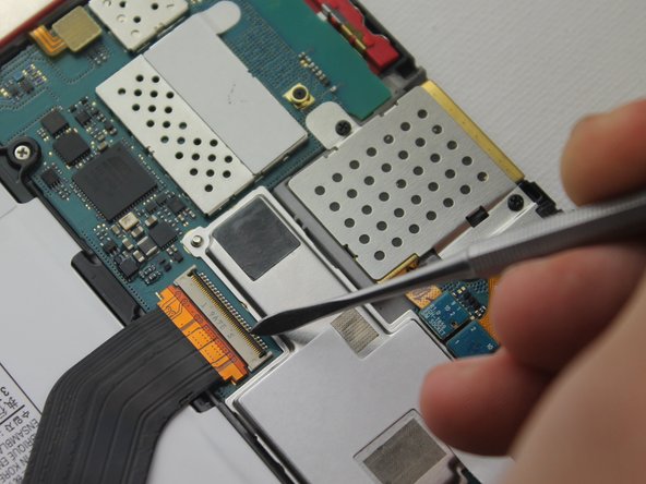

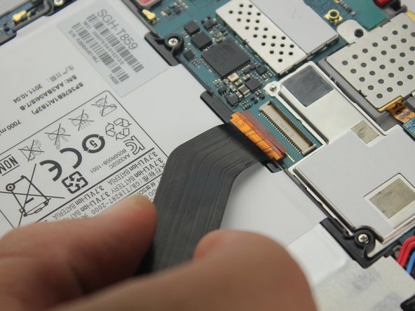

  8. Samsung Galaxy Tab 10.1 4G Battery Replacement: crwdns2935265:08crwdnd2935265:01crwdnd2935265:03crwdne2935265:0 Samsung Galaxy Tab 10.1 4G Battery Replacement: crwdns2935265:08crwdnd2935265:02crwdnd2935265:03crwdne2935265:0 Samsung Galaxy Tab 10.1 4G Battery Replacement: crwdns2935265:08crwdnd2935265:03crwdnd2935265:03crwdne2935265:0
    • Carefully slide a plastic spudger under the black strip of plastic on the far side of the ribbon connector housing.
    • When working with electronics, it's important to choose a tool that's ESD-safe to avoid accidental damage to the device. The regular black nylon spudger or a plastic opening tool should be used whenever possible.
    • Lift the black strip upwards. This will release the ribbon.
    • Slide the ribbon out of the connector.
    • Repeat this step to release the other two ribbons.
    • You will need to remove the tape from covering those connectors, too.

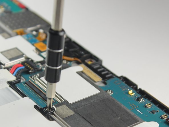

  9. Samsung Galaxy Tab 10.1 4G Battery Replacement: crwdns2935265:09crwdnd2935265:01crwdnd2935265:02crwdne2935265:0 Samsung Galaxy Tab 10.1 4G Battery Replacement: crwdns2935265:09crwdnd2935265:02crwdnd2935265:02crwdne2935265:0
    • Use the Phillips #00 screwdriver to unscrew the 10 3mm screws holding the battery in place.
  10. Samsung Galaxy Tab 10.1 4G Battery Replacement: crwdns2935265:010crwdnd2935265:01crwdnd2935265:01crwdne2935265:0
    • Lift the battery out of its housing to remove it.
