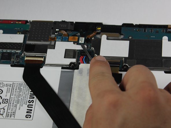

    • When working with electronics, it's important to choose a tool that's ESD-safe to avoid accidental damage to the device. The regular black nylon spudger or a plastic opening tool should be used whenever possible.
    • The connection between the battery and motherboard is a group of four wires in black housing that can be found near the top middle of the device. Using a plastic spudger or a flat, slim tool, lift the black connector housing upwards to disconnect it.

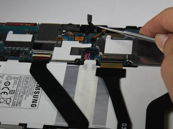

  7. Samsung Galaxy Tab 10.1 4G Back Facing Camera Replacement, Back Facing Camera: crwdns2935265:07crwdnd2935265:01crwdnd2935265:03crwdne2935265:0 Samsung Galaxy Tab 10.1 4G Back Facing Camera Replacement, Back Facing Camera: crwdns2935265:07crwdnd2935265:02crwdnd2935265:03crwdne2935265:0 Samsung Galaxy Tab 10.1 4G Back Facing Camera Replacement, Back Facing Camera: crwdns2935265:07crwdnd2935265:03crwdnd2935265:03crwdne2935265:0
    • Disconnect the rectangular connection from the rear camera to the motherboard.
    • A group of five connections are all together. Starting from the left, the fourth connection is the one you want to remove.
  8. Samsung Galaxy Tab 10.1 4G Back Facing Camera Replacement: crwdns2935265:08crwdnd2935265:01crwdnd2935265:01crwdne2935265:0
    • Remove the back facing camera.
