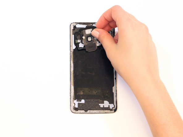

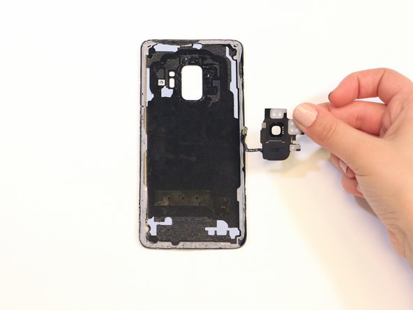

    1. Samsung Galaxy S9 Fingerprint Sensor Replacement, Fingerprint Sensor: crwdns2935265:08crwdnd2935265:01crwdnd2935265:01crwdne2935265:0
      • Heat up the iOpener in the microwave for 30-60 seconds.
      • Place the iOpener on the back cover for 2-3 minutes to heat up the adhesive holding the fingerprint sensor.
      • The iOpener may still be warm from earlier steps. You may not need to microwave it again.
    2. Samsung Galaxy S9 Fingerprint Sensor Replacement: crwdns2935265:09crwdnd2935265:01crwdnd2935265:03crwdne2935265:0 Samsung Galaxy S9 Fingerprint Sensor Replacement: crwdns2935265:09crwdnd2935265:02crwdnd2935265:03crwdne2935265:0 Samsung Galaxy S9 Fingerprint Sensor Replacement: crwdns2935265:09crwdnd2935265:03crwdnd2935265:03crwdne2935265:0
      • Carefully slide the Jimmy under the fingerprint sensor.
      • Peel off the fingerprint sensor from the back cover.
