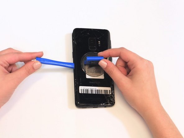

    • Press the suction handle firmly on to the back cover.
    • Insert an opening pick between the back cover and the device's body while pulling upwards on the suction handle.

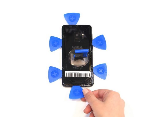

    • Apply more opening picks to the edges of the phone, heating the other sides as needed.
    • Be patient. This step requires quite a bit of work. The adhesive is difficult to melt, making it time-consuming to remove the back of the phone.
    • Because the back panel is made of glass, inserting and sliding the opening picks is likely to crack the glass. If the glass does shatter, please cover it with packing tape to protect your hands from the sharp edges and fragments.

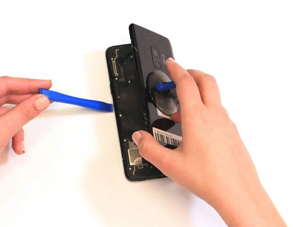

    • Use the iFixit opening tool to separate the back cover from the rest of the device.
  5. Samsung Galaxy S9 Back Cover Replacement: crwdns2935265:05crwdnd2935265:01crwdnd2935265:01crwdne2935265:0
    • Remove the back cover.
