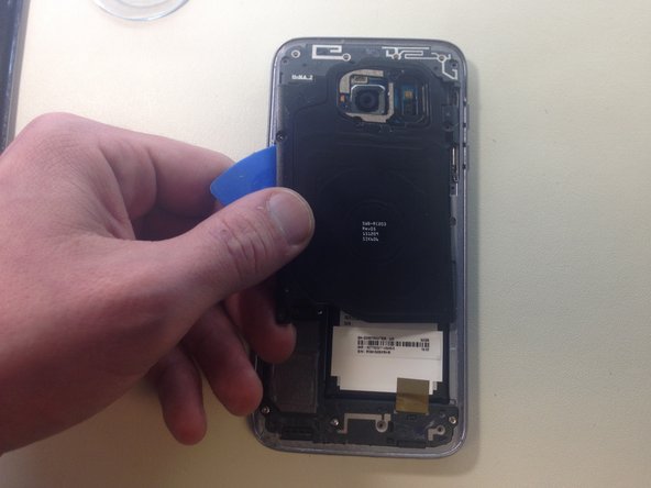

  3. Samsung Galaxy S7 Screen Assembly Replacement, Remove the plastic covers: crwdns2935265:03crwdnd2935265:01crwdnd2935265:03crwdne2935265:0 Samsung Galaxy S7 Screen Assembly Replacement, Remove the plastic covers: crwdns2935265:03crwdnd2935265:02crwdnd2935265:03crwdne2935265:0 Samsung Galaxy S7 Screen Assembly Replacement, Remove the plastic covers: crwdns2935265:03crwdnd2935265:03crwdnd2935265:03crwdne2935265:0
    • Using a Phillips #00 screw driver bit, remove the 11 screws holding the plastic covers, loudspeaker, and NFC antenna on.
    • Using a guitar pick to break some light adhesive, remove the top two plastic plates, and the NFC antenna.
    • NOTE: If the adhesive is too strong, try applying more heat.
    • Remove the loudspeaker assembly. You may have to peel up a small piece of gold/copper tape holding the assembly to the battery.

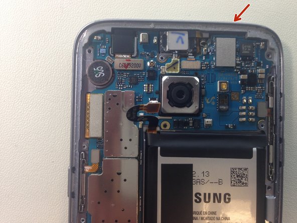

  4. Samsung Galaxy S7 Screen Assembly Replacement, Disconnect the battery: crwdns2935265:04crwdnd2935265:01crwdnd2935265:01crwdne2935265:0
    • Using the flat end of a spudger, disconnect the battery from the logic board.
  5. Samsung Galaxy S7 Screen Assembly Replacement, Disconnect the flex cables: crwdns2935265:05crwdnd2935265:01crwdnd2935265:02crwdne2935265:0 Samsung Galaxy S7 Screen Assembly Replacement, Disconnect the flex cables: crwdns2935265:05crwdnd2935265:02crwdnd2935265:02crwdne2935265:0
    • Disconnect all other flex cables connected to the top of the logic board using the flat end of a plastic spudger.

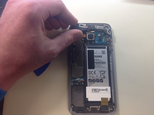

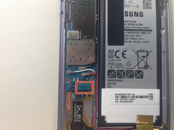

  6. Samsung Galaxy S7 Screen Assembly Replacement, Disconnect the antennas and remove the SIM: crwdns2935265:06crwdnd2935265:01crwdnd2935265:02crwdne2935265:0 Samsung Galaxy S7 Screen Assembly Replacement, Disconnect the antennas and remove the SIM: crwdns2935265:06crwdnd2935265:02crwdnd2935265:02crwdne2935265:0
    • Using the pointed end of a plastic spudger, disconnect the white and red antenna cables from the logic board.
    • Using a SIM card removal tool, eject the SIM Card/SD Card tray (Image 2 of this step. This tray is attached to the back of the logic board. Removing the logic board before doing this may damage it.)
  7. Samsung Galaxy S7 Screen Assembly Replacement, Disconnect the daughter board: crwdns2935265:07crwdnd2935265:01crwdnd2935265:01crwdne2935265:0
    • Gently lift the logic board up from the top of the phone towards the battery. DO NOT completely remove the logic board yet.
    • NOTE: As you lift the logic board out, the front facing camera may fall out of the phone. If it does, set it to the side, on an anti-static mat.
    • Using the flat end of a spudger, disconnect the USB daughter board connector from the back of the logic board.
    • Remove the logic board, placing it to the side on an anti-static surface.
