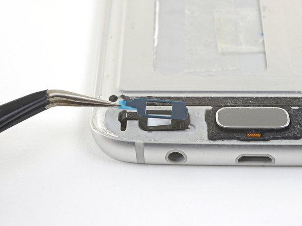

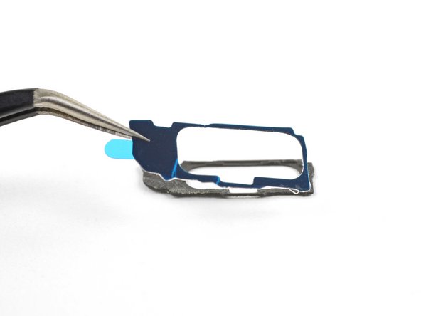

    • Peel off the white backing from the fingerprint bracket adhesive.
    • Carefully align and apply the adhesive to the fingerprint bracket.
    • Use your fingers to press the adhesive onto the bracket.
    • Use tweezers to peel off the blue plastic liner from the adhesive.

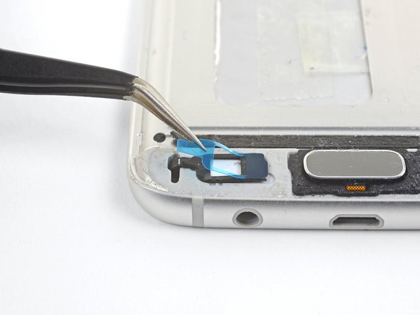

    • Carefully lay the bracket around the fingerprint sensor. The bracket holds the sensor in place, so it is important to ensure that it is well aligned.
    • Once the bracket is aligned, use the flat edge of a spudger or a finger to press the bracket in place.

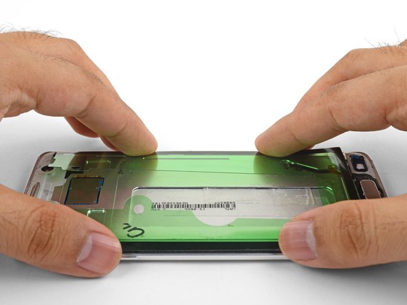

    • Peel and remove the green plastic liner from all adhesive strips to expose the screen-facing adhesive.
    • Align and set the phone screen on top of the adhesive.
    • Use your fingers to squeeze around the perimeter of the phone to set the adhesive.
    • Apply a few books worth of weight on top of the screen for an hour to help the adhesive bond.
