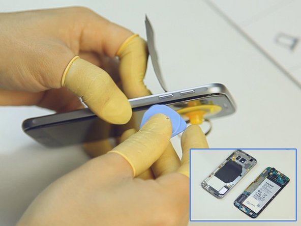

  2. Samsung Galaxy S6 Teardown, Take Apart The Battery Door.: crwdns2935265:02crwdnd2935265:01crwdnd2935265:01crwdne2935265:0
    • Heat up the Samsung Galaxy S6 Battery Door.
    • Draw the battery cover up with a suction cup. (Note: The battery door is adhered to the rear housing with quite strong adhesive, take your time during this process.)
    • Separate the battery door with an opening pick.

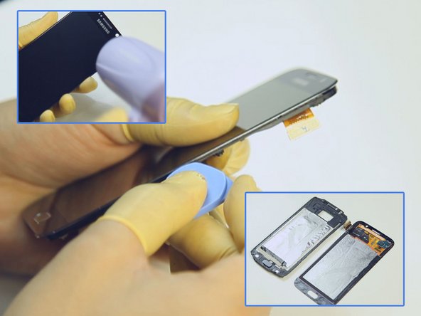

    • Undo the 13 screws in the rear housing.
    • Heat up the LCD Assembly.
    • Separate the rear housing from the LCD Assembly with the help of suction cup tool and case opening tool. (Notice: be careful not to damage the wireless charging chip attached to the battery.)

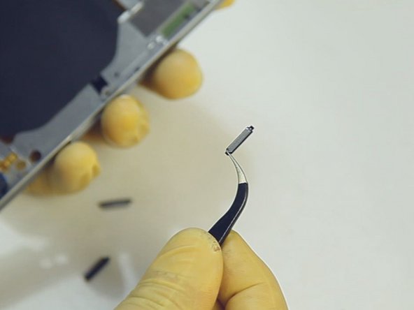

    • Remove the power button flex.
    • Remove the volume button flex.
    • Remove the side keys. (Note: the Galaxy S6 power button and volume buttons are compatible with each other.)

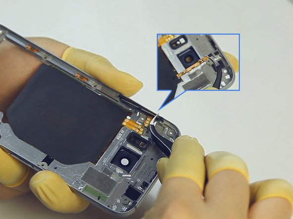

  5. Samsung Galaxy S6 Teardown, Release The Wireless Charging Chip.: crwdns2935265:05crwdnd2935265:01crwdnd2935265:01crwdne2935265:0
    • Pry up the charging chip flex ribbons on both sides of rear housing. (Notice: be careful not to damage the flex ribbons.)

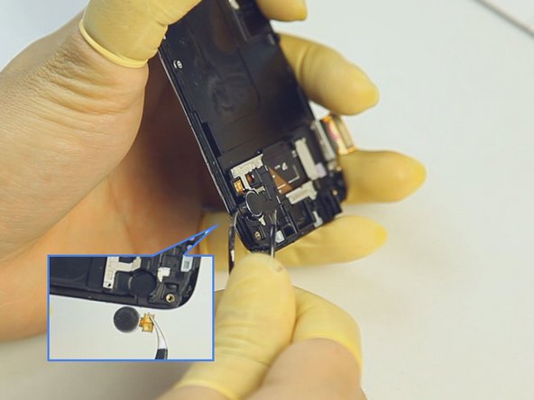

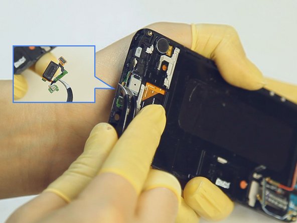

  8. Samsung Galaxy S6 Teardown, Release The Front Housing Small Parts.: crwdns2935265:08crwdnd2935265:01crwdnd2935265:03crwdne2935265:0 Samsung Galaxy S6 Teardown, Release The Front Housing Small Parts.: crwdns2935265:08crwdnd2935265:02crwdnd2935265:03crwdne2935265:0 Samsung Galaxy S6 Teardown, Release The Front Housing Small Parts.: crwdns2935265:08crwdnd2935265:03crwdnd2935265:03crwdne2935265:0
    • Remove the front facing camera.
    • Remove the ear speaker. (Notice: be careful not to break the flex ribbon.)
    • Remove the vibrating motor.

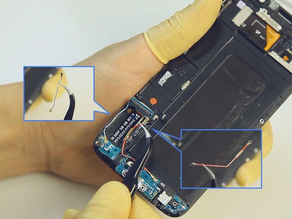

  9. Samsung Galaxy S6 Teardown, Release The Back Camera And Signal Cables.: crwdns2935265:09crwdnd2935265:01crwdnd2935265:02crwdne2935265:0 Samsung Galaxy S6 Teardown, Release The Back Camera And Signal Cables.: crwdns2935265:09crwdnd2935265:02crwdnd2935265:02crwdne2935265:0
    • Remove the back facing camera on the mainboard.
    • Remove the Bluetooth cable and Wi-Fi signal cable.

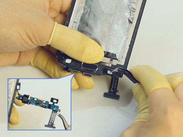

  10. Samsung Galaxy S6 Teardown, Release The Charging Port Assembly.: crwdns2935265:010crwdnd2935265:01crwdnd2935265:03crwdne2935265:0 Samsung Galaxy S6 Teardown, Release The Charging Port Assembly.: crwdns2935265:010crwdnd2935265:02crwdnd2935265:03crwdne2935265:0 Samsung Galaxy S6 Teardown, Release The Charging Port Assembly.: crwdns2935265:010crwdnd2935265:03crwdnd2935265:03crwdne2935265:0
    • Undo the earphone jack screw. (Notice: the screw is different than the rear housing screws.)
    • Heat up the LCD Assembly to release the front housing.
    • Pry up the navigation light stickers.
