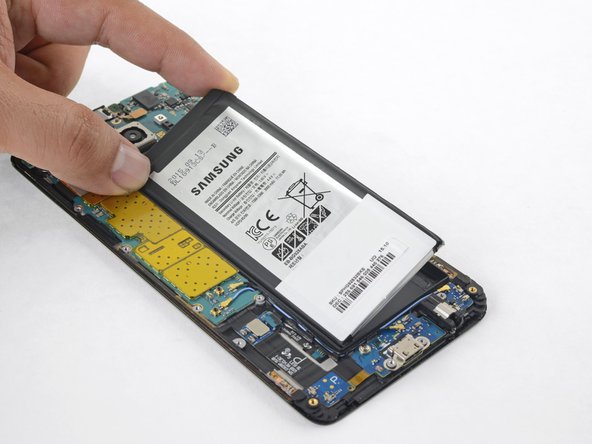

    • Insert an opening pick between the display frame and the battery.
    • You may need to slide the pick back and forth a few times before it slides into the gap between the frame and the battery.
    • Slide the pick underneath the battery as far as you can while maintaining a firm grip on the pick.
    • Slide the pick down the side of the battery to break up the adhesive underneath.
    • Try your best not to deform the battery during this process. Soft-shell lithium-ion batteries can leak dangerous chemicals, catch fire, or even explode if damaged. Do not use excessive force or pry at the battery with metal tools.
  10. Samsung Galaxy S6 Edge+ Battery Replacement: crwdns2935265:010crwdnd2935265:01crwdnd2935265:02crwdne2935265:0 Samsung Galaxy S6 Edge+ Battery Replacement: crwdns2935265:010crwdnd2935265:02crwdnd2935265:02crwdne2935265:0
    • Twist the opening pick to lift the battery away from the display frame.
    • Remove the battery.
    • To install a new battery:
    • Remove any remaining adhesive from the phone, and clean the glued areas with isopropyl alcohol and a lint-free cloth.
    • Secure the new battery with pre-cut adhesive or double-sided adhesive tape. In order to position it correctly, apply the new adhesive into the phone, not directly onto the battery. The adhesive should go around the perimeter of the battery compartment, but not in the rectangular cutout in the center (which is actually the back side of the display).
    • Press the battery firmly into place for 5-10 seconds.
After completing this guide, calibrate your newly-installed battery.
