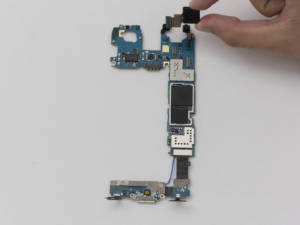

    1. Samsung Galaxy S5 Rear Camera Replacement, Motherboard: crwdns2935265:014crwdnd2935265:01crwdnd2935265:01crwdne2935265:0
      • Remove the single silver 4 mm screw from below the rear camera with a Phillips#00 screw driver.
    2. Samsung Galaxy S5 Rear Camera Replacement: crwdns2935265:015crwdnd2935265:01crwdnd2935265:01crwdne2935265:0
      • Remove the single black 4 mm screw from above the charging port with a Phillips#00 head screw driver.
    3. Samsung Galaxy S5 Rear Camera Replacement: crwdns2935265:016crwdnd2935265:01crwdnd2935265:03crwdne2935265:0 Samsung Galaxy S5 Rear Camera Replacement: crwdns2935265:016crwdnd2935265:02crwdnd2935265:03crwdne2935265:0 Samsung Galaxy S5 Rear Camera Replacement: crwdns2935265:016crwdnd2935265:03crwdnd2935265:03crwdne2935265:0
      • Flip the device over
      • Use the plastic opening tool to remove the black plastic covers at the bottom of the phone.
      • When putting the phone back together remember that these plastic covers have light adhesive on the back that may need to be reapplied.
    4. Samsung Galaxy S5 Rear Camera Replacement: crwdns2935265:017crwdnd2935265:01crwdnd2935265:02crwdne2935265:0 Samsung Galaxy S5 Rear Camera Replacement: crwdns2935265:017crwdnd2935265:02crwdnd2935265:02crwdne2935265:0
      • Be careful not to apply too much pressure when removing the cable. If too much pressure is applied, the cable or the connection to the motherboard can be destroyed.
      • Use the plastic opening tool to remove the ribbon cable connecting the home button to the motherboard.
    5. Samsung Galaxy S5 Rear Camera Replacement: crwdns2935265:018crwdnd2935265:01crwdnd2935265:02crwdne2935265:0 Samsung Galaxy S5 Rear Camera Replacement: crwdns2935265:018crwdnd2935265:02crwdnd2935265:02crwdne2935265:0
      • Gently lift the motherboard off of the second midframe with the plastic opening tool.
    1. Samsung Galaxy S5 Rear Camera Replacement, Rear Camera: crwdns2935265:019crwdnd2935265:01crwdnd2935265:02crwdne2935265:0 Samsung Galaxy S5 Rear Camera Replacement, Rear Camera: crwdns2935265:019crwdnd2935265:02crwdnd2935265:02crwdne2935265:0
      • Use the plastic opening tool to gently remove the ribbon cable connecting the rear camera to the motherboard.
