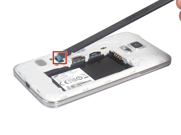

    • Open this small cover and release the home button flex connector.

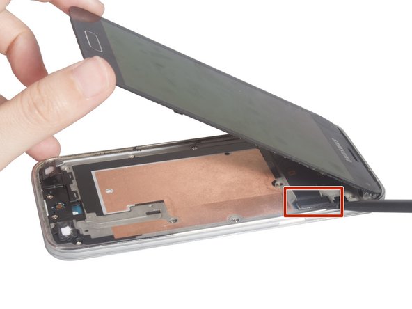

    • Heat up the screen and cut the adhesive around the screen. Pry it up and release the LCD screen connector.
    • The connector is located at the top right of the screen, so lift it up or to the left.

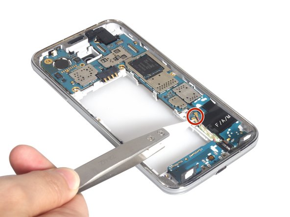

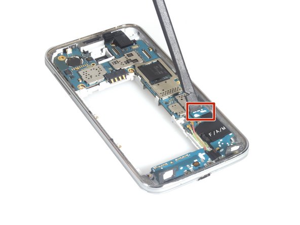

    • Remove screw, release USB board flex connector and antenna cable connectors.
  9. Samsung Galaxy S5 Mini Daughterboard Replacement: crwdns2935265:09crwdnd2935265:01crwdnd2935265:02crwdne2935265:0 Samsung Galaxy S5 Mini Daughterboard Replacement: crwdns2935265:09crwdnd2935265:02crwdnd2935265:02crwdne2935265:0
    • Remove the daughterboard and clean the signal cables from assembly. And you can replace the new USB charging board for Samsung Galaxy S5 Mini.
