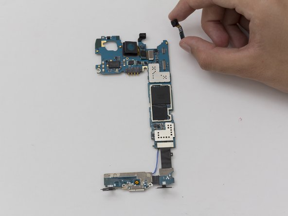

    • Gently lift the motherboard off of the second midframe with the plastic opening tool.
  19. Samsung Galaxy S5 Front Camera Replacement, Front Camera: crwdns2935265:019crwdnd2935265:01crwdnd2935265:02crwdne2935265:0 Samsung Galaxy S5 Front Camera Replacement, Front Camera: crwdns2935265:019crwdnd2935265:02crwdnd2935265:02crwdne2935265:0
    • Use the plastic opening tool to gently remove the ribbon cable connecting the front camera to the motherboard.
