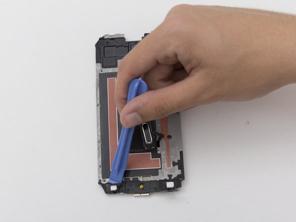

    • Continue to lift the display. You will notice a black cable connecting the home button to the motherboard.
    • Use the plastic opening tool to pry the home button off. Moderate force is required.
    • When reassembling the phone you may need to apply glue to the button to keep it in place.
    • When putting the new screen in place you will need to put double sided tape attaching it to the midframe to stop it from wobbling when in use.

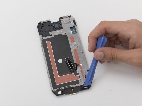

  12. Samsung Galaxy S5 Charging Port Replacement: crwdns2935265:012crwdnd2935265:01crwdnd2935265:01crwdne2935265:0
    • Flip the device over and remove the three 5mm screws with a Phillips#00 head screw driver.
  13. Samsung Galaxy S5 Charging Port Replacement: crwdns2935265:013crwdnd2935265:01crwdnd2935265:03crwdne2935265:0 Samsung Galaxy S5 Charging Port Replacement: crwdns2935265:013crwdnd2935265:02crwdnd2935265:03crwdne2935265:0 Samsung Galaxy S5 Charging Port Replacement: crwdns2935265:013crwdnd2935265:03crwdnd2935265:03crwdne2935265:0

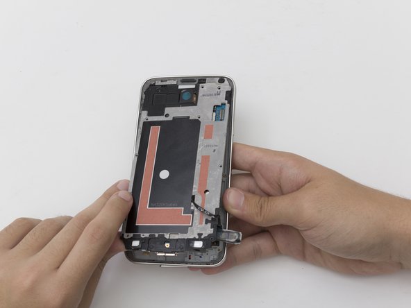

    • Flip the phone back over. First, unlatch the charging port flap at the bottom of the device with your finger.

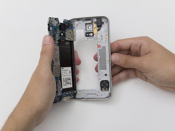

    • Press firmly on corners of the midframe while holding on to the plastic bezel (the outer plastic ring).
    • Hold the device in one hand. Then apply pressure with your fingers to the back of the frame at the top of where the battery was. Then remove the midframe by pulling it outwards and towards the top of the phone.
    • When putting the phone back together, insert the bottom first by inserting the charging port into the notch shaped for it. You must do this first or the midframe will not fit in the plastic bezel.

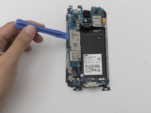

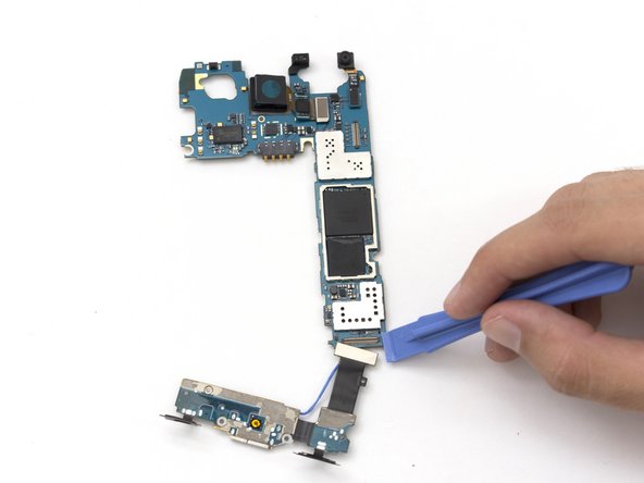

  18. Samsung Galaxy S5 Charging Port Replacement: crwdns2935265:018crwdnd2935265:01crwdnd2935265:02crwdne2935265:0 Samsung Galaxy S5 Charging Port Replacement: crwdns2935265:018crwdnd2935265:02crwdnd2935265:02crwdne2935265:0
    • Gently lift the motherboard off of the second midframe with the plastic opening tool.

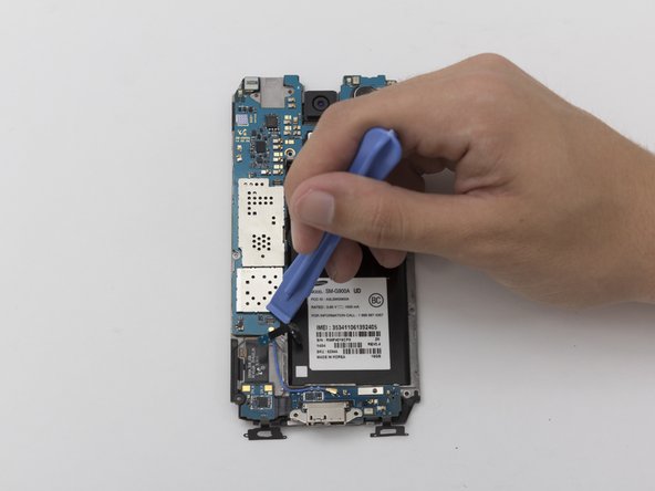

  19. Samsung Galaxy S5 Charging Port Replacement, Charging Port: crwdns2935265:019crwdnd2935265:01crwdnd2935265:02crwdne2935265:0 Samsung Galaxy S5 Charging Port Replacement, Charging Port: crwdns2935265:019crwdnd2935265:02crwdnd2935265:02crwdne2935265:0
    • Gently use the plastic opening tool to remove the blue cable connecting the home button to the motherboard.

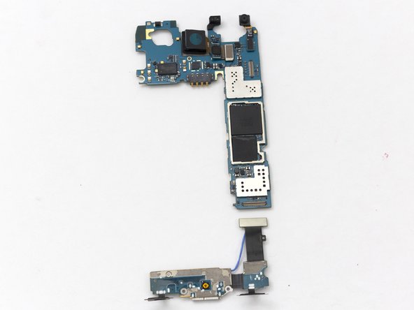

  20. Samsung Galaxy S5 Charging Port Replacement: crwdns2935265:020crwdnd2935265:01crwdnd2935265:03crwdne2935265:0 Samsung Galaxy S5 Charging Port Replacement: crwdns2935265:020crwdnd2935265:02crwdnd2935265:03crwdne2935265:0 Samsung Galaxy S5 Charging Port Replacement: crwdns2935265:020crwdnd2935265:03crwdnd2935265:03crwdne2935265:0

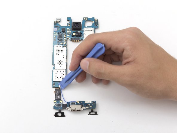

    • Flip the mother board over.
    • Gently use the plastic opening tool to remove the black ribbon cable connecting the charging port to the mother board.
