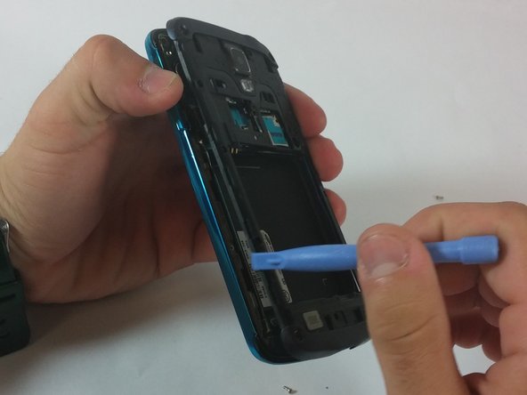

  5. Samsung Galaxy S4 Active Speaker Replacement, Midframe removal: crwdns2935265:05crwdnd2935265:01crwdnd2935265:02crwdne2935265:0 Samsung Galaxy S4 Active Speaker Replacement, Midframe removal: crwdns2935265:05crwdnd2935265:02crwdnd2935265:02crwdne2935265:0
    • Using the provided screwdriver, remove the (8) 4.0 mm Phillips #00 screws that hold the midframe in place.
    • Starting on the volume button side of the phone, insert your plastic opening tool into the seam between the display glass and the larger chrome border piece
    • Slide the opening tool along the seam in either direction. Plastic clips will become separated.
    • Once you have pried off all of the plastic clips around the perimeter of the phone, you may remove the midframe from the display.

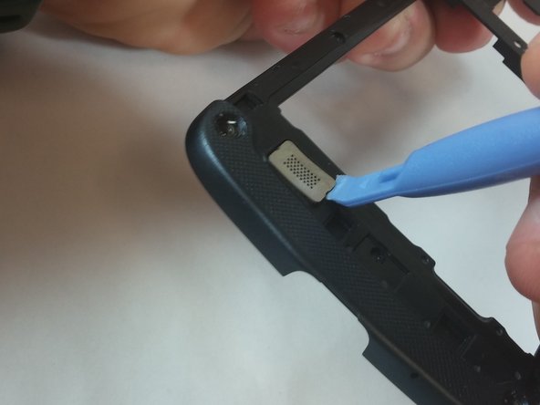

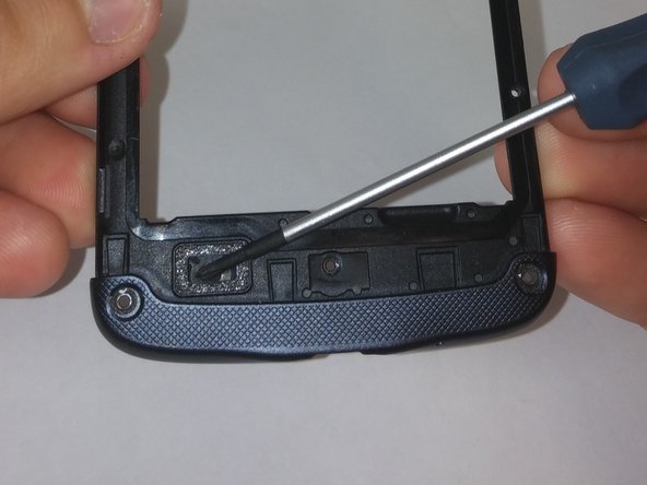

  6. Samsung Galaxy S4 Active Speaker Replacement, Speaker enclosure removal: crwdns2935265:06crwdnd2935265:01crwdnd2935265:03crwdne2935265:0 Samsung Galaxy S4 Active Speaker Replacement, Speaker enclosure removal: crwdns2935265:06crwdnd2935265:02crwdnd2935265:03crwdne2935265:0 Samsung Galaxy S4 Active Speaker Replacement, Speaker enclosure removal: crwdns2935265:06crwdnd2935265:03crwdnd2935265:03crwdne2935265:0
    • Hold the midframe in one hand and the speaker enclosure in your other hand.
    • Use the prying tool to pry off the silver screen side of the speaker.
    • Use a sharp tool to poke out the speaker enclosure.
  7. Samsung Galaxy S4 Active Speaker Replacement, New speaker replacement: crwdns2935265:07crwdnd2935265:01crwdnd2935265:01crwdne2935265:0
    • Insert your new speaker, in its enclosure, back onto the midframe.
