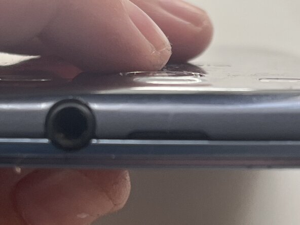

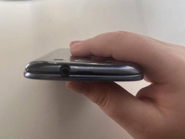

    • Pry up the rear casing using the clip near the headphone jack shown in picture 2.
    • Do not force the back off on any other side, or else you risk breaking the plastic clips that hold it in place!

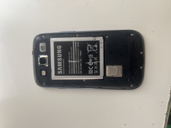

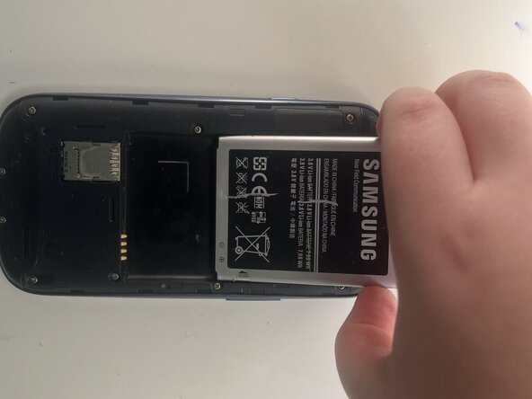

  2. Samsung Galaxy S3 Neo Motherboard Replacement, Battery: crwdns2935265:02crwdnd2935265:01crwdnd2935265:03crwdne2935265:0 Samsung Galaxy S3 Neo Motherboard Replacement, Battery: crwdns2935265:02crwdnd2935265:02crwdnd2935265:03crwdne2935265:0 Samsung Galaxy S3 Neo Motherboard Replacement, Battery: crwdns2935265:02crwdnd2935265:03crwdnd2935265:03crwdne2935265:0
    • Remove the battery via the small opening near the flash.
    • Be careful when removing the battery; it can be punctured.
    • Do not forget to turn off the phone before removing the battery!
