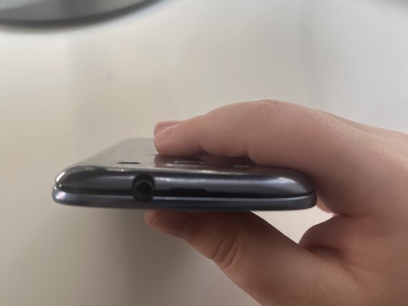

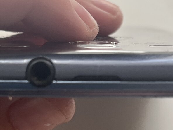

    • Pry up the rear casing using the clip near the headphone jack shown in picture 2.
    • You may use a spudger for your this step. A jimmy tool may be used but is not recommended.
    • Do not force the back off on any other side!

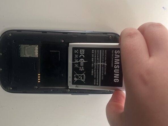

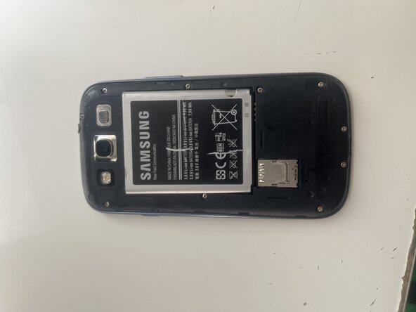

    • Remove the battery via the small opening near the flash.
    • You may use a spudger for this. A jimmy tool is not recommended and should not be used.
    • Do not forget to turn off the phone before removing the battery!
    • Be careful when removing the battery; it can be punctured.
