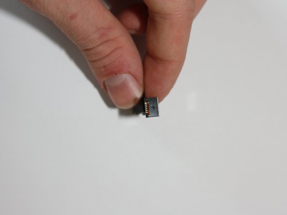

    • The (tiny) 8MP camera.
    • It's smaller than an iPhone 4 camera.

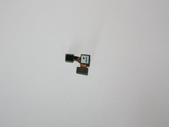

    • The front-facing camera and the light sensor are a single part.
    • The front-facing camera is 2MP, which is better than the iPhone 4's VGA camera.

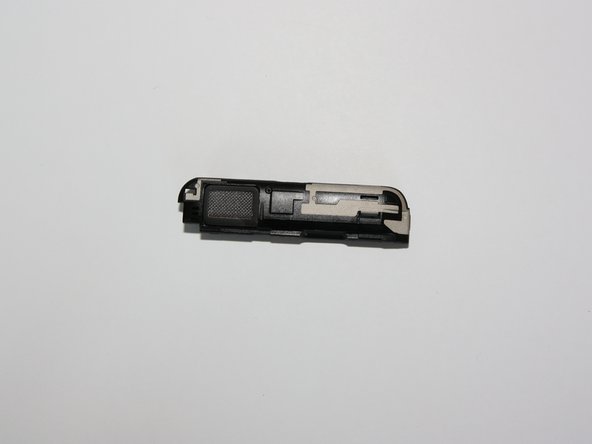

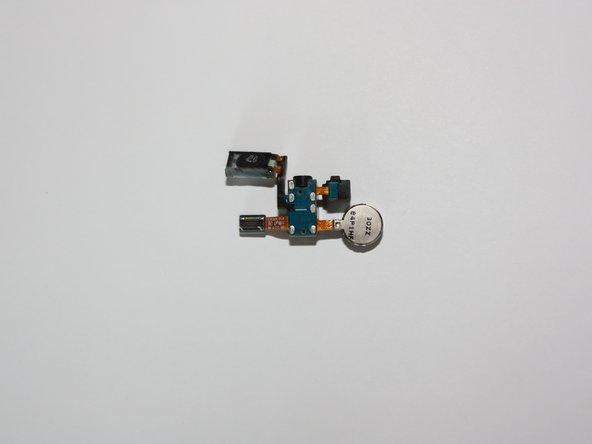

    • The vibrator, first mic (did you know there are two?), cinch plug and the earspeaker.

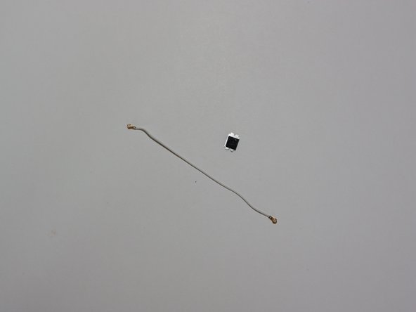

    • The (only) antenna cable and a metal shield holding the light sensor in place.
