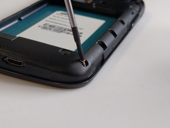

    • Use a Phillips #00 screwdriver to remove the eight 4 mm screws from the device frame.
  4. Samsung Galaxy S Blaze SD Card Slot Cover Replacement: crwdns2935265:04crwdnd2935265:01crwdnd2935265:01crwdne2935265:0
    • Use the blue plastic opening tool to gently pry the frame off the phone.
    • Work around the phone with the blue plastic opening tool until the frame is off.
    • You may need to use a bit of force to pry off the frame.

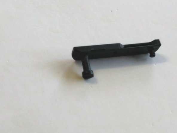

  5. Samsung Galaxy S Blaze SD Card Slot Cover Replacement: crwdns2935265:05crwdnd2935265:01crwdnd2935265:02crwdne2935265:0 Samsung Galaxy S Blaze SD Card Slot Cover Replacement: crwdns2935265:05crwdnd2935265:02crwdnd2935265:02crwdne2935265:0
    • The SD cover is held in place on the frame by a small tab.
    • Unhook the tab of the SD card slot cover from the frame of the device.
    • This is what the tab of the SD card slot cover looks like.
