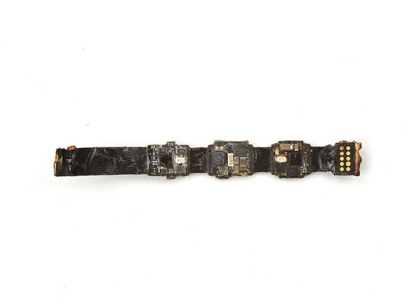

  1. Samsung Galaxy Ring Chip ID, Main Board Side 1: crwdns2935265:01crwdnd2935265:01crwdnd2935265:02crwdne2935265:0 Samsung Galaxy Ring Chip ID, Main Board Side 1: crwdns2935265:01crwdnd2935265:02crwdnd2935265:02crwdne2935265:0
    • Photodiodes
    • LEDs

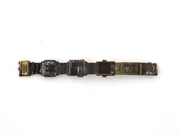

  2. Samsung Galaxy Ring Chip ID, Main Board Side 2: crwdns2935265:02crwdnd2935265:01crwdnd2935265:02crwdne2935265:0 Samsung Galaxy Ring Chip ID, Main Board Side 2: crwdns2935265:02crwdnd2935265:02crwdnd2935265:02crwdne2935265:0
    • Analog Devices MAX77659X power management
    • Likely NXP Semiconductors wireless charging controller
    • Likely GigaDevice serial NOR flash memory
  3. Samsung Galaxy Ring Chip ID, Main Board Side 2 - Connectivity: crwdns2935265:03crwdnd2935265:01crwdnd2935265:01crwdne2935265:0
    • Nordic Semiconductor nRF5340 dual-core Bluetooth 5.4 SoC
    • NXP Semiconductors NT3H2111W0FHKH NFC tag
    • Antenna

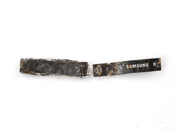

  4. Samsung Galaxy Ring Chip ID, Battery & Wireless Charging Coil Assembly: crwdns2935265:04crwdnd2935265:01crwdnd2935265:02crwdne2935265:0 Samsung Galaxy Ring Chip ID, Battery & Wireless Charging Coil Assembly: crwdns2935265:04crwdnd2935265:02crwdnd2935265:02crwdne2935265:0
    • Wireless charging coil
    • Battery pack
Is there any AFE (analog front end) associated with the optical sensor for heart rate measurement?
