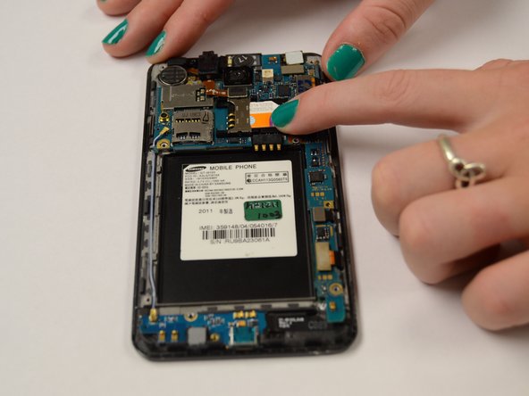

  4. Samsung Galaxy R SIM Card Replacement, SIM Card: crwdns2935265:04crwdnd2935265:01crwdnd2935265:03crwdne2935265:0 Samsung Galaxy R SIM Card Replacement, SIM Card: crwdns2935265:04crwdnd2935265:02crwdnd2935265:03crwdne2935265:0 Samsung Galaxy R SIM Card Replacement, SIM Card: crwdns2935265:04crwdnd2935265:03crwdnd2935265:03crwdne2935265:0
    • Remove or replace SIM Card by pushing into metal slot above the battery holder.
