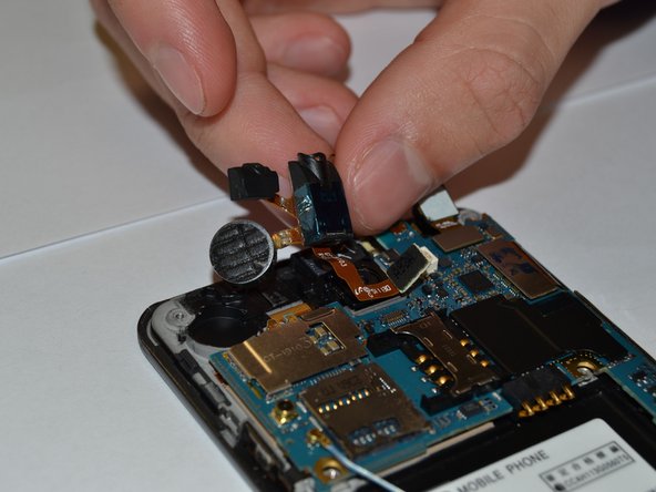

  4. Samsung Galaxy R Headphone Jack Replacement, Headphone Jack: crwdns2935265:04crwdnd2935265:01crwdnd2935265:03crwdne2935265:0 Samsung Galaxy R Headphone Jack Replacement, Headphone Jack: crwdns2935265:04crwdnd2935265:02crwdnd2935265:03crwdne2935265:0 Samsung Galaxy R Headphone Jack Replacement, Headphone Jack: crwdns2935265:04crwdnd2935265:03crwdnd2935265:03crwdne2935265:0
    • The headphone jack is located near the top left side of the motherboard.
    • To remove the headphone jack, gently pull on the area indicated in red until it detaches from the motherboard.
