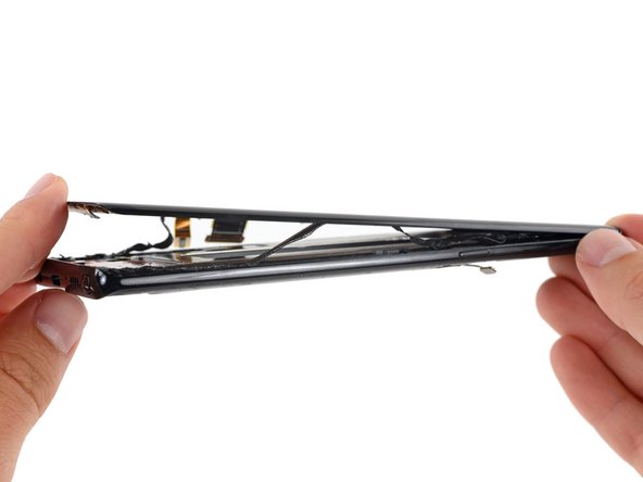

    • This glue-ridden heat-pry-and-slice opening procedure is certainly not our favorite, but at least by now it's getting familiar. As usual, it all starts with our trusty iOpener.
    • Cracking open the phone, we spy a delicate fingerprint sensor cable. This makes carving through all that glue a bit treacherous as the cable might be easy to slice right through if you aren't expecting it.

    • The Note8's OLED panel has been much ballyhooed, with many superlatives, but we're mostly just interested in how it comes off.
    • Answer: bring heat and alllllll your opening picks.
    • This Samsung-manufactured display bests all previous smartphone displays and represents a significant step forward from what we saw in the S8 series just a few months ago. Small wonder that a certain fruit company wants in on the action.

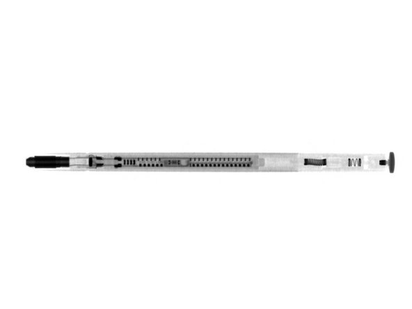

    • With both the Note7 and Note8 styluses on hand, we couldn't help but do our own comparison—Star Wars style.
    • After glorious combat we asked our friends at Creative Electron to show us the inner-workings of the S Pen.
    • Unfortunately, they found no kyber crystals.
