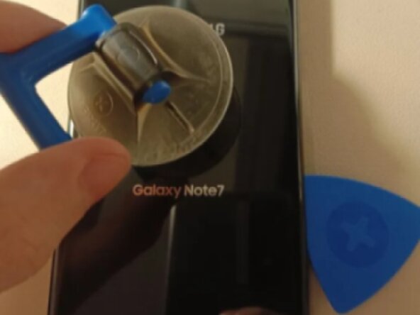

    • Apply heat to the back panel, use a guitar pick and suction cup to carefully remove the adhesive and remove the back panel.

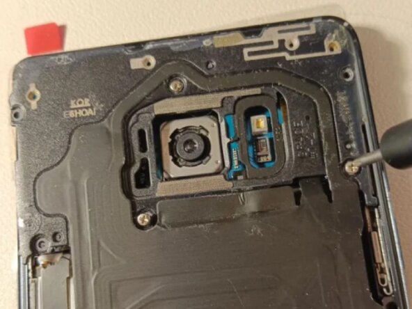

    • Remove the screws holding the wireless charging and NFC cover in place using a 00 screwdriver, then lift it off.
  3. Samsung Galaxy Note7 Screen Assembly Replacement: crwdns2935265:03crwdnd2935265:01crwdnd2935265:01crwdne2935265:0
