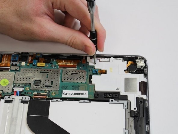

    • Make sure the device is powered off before starting repair.
    • Carefully remove the back cover with the blue opening tool.
    • It is best to start with one corner and work your way around the device slowly.
  2. Samsung Galaxy Note Pro 12.2 Speakers Replacement: crwdns2935265:02crwdnd2935265:01crwdnd2935265:02crwdne2935265:0 Samsung Galaxy Note Pro 12.2 Speakers Replacement: crwdns2935265:02crwdnd2935265:02crwdnd2935265:02crwdne2935265:0
    • Remove the one 3mm Phillips #00 screw securing the black speaker.
  3. Samsung Galaxy Note Pro 12.2 Speakers Replacement: crwdns2935265:03crwdnd2935265:01crwdnd2935265:01crwdne2935265:0
    • Using the plastic opening tool, pop the black speaker up and away from the device.
  4. Samsung Galaxy Note Pro 12.2 Speakers Replacement: crwdns2935265:04crwdnd2935265:01crwdnd2935265:02crwdne2935265:0 Samsung Galaxy Note Pro 12.2 Speakers Replacement: crwdns2935265:04crwdnd2935265:02crwdnd2935265:02crwdne2935265:0
    • Remove the two 3mm screws securing the white speaker with the Phillips #00 screwdriver.
  5. Samsung Galaxy Note Pro 12.2 Speakers Replacement: crwdns2935265:05crwdnd2935265:01crwdnd2935265:01crwdne2935265:0
    • Using the blue opening tool pop the white speaker up and away from the device.
