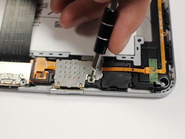

    • Remove the one 3mm Phillips #00 screw connected to the SD port.

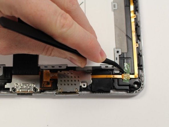

    • Pop open the orange wire tab connected to the SD port with the plastic opening tool.
    • If there is tape covering your tab, remove it with the tweezers before you pop open the tab.

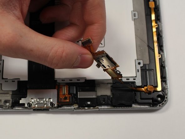

    • Using the orange tab, pull the SD port up and away from the device.
  6. Samsung Galaxy Note Pro 12.2 SD Port Replacement: crwdns2935265:06crwdnd2935265:01crwdnd2935265:01crwdne2935265:0
    • Using the plastic end of the tweezers pop up the orange tab connecting the SD port to the device.
    • There is a little indent below the orange tab to help get under this piece. It may be difficult to remove, push up hard.
