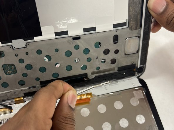

    • Remove the back of the tablet with a plastic opening tool.
  2. Samsung Galaxy Note Pro 12.2 Buttons Replacement: crwdns2935265:02crwdnd2935265:01crwdnd2935265:02crwdne2935265:0 Samsung Galaxy Note Pro 12.2 Buttons Replacement: crwdns2935265:02crwdnd2935265:02crwdnd2935265:02crwdne2935265:0
    • Pull apart the front and back of the tablet while keeping the plastic opening tool in device.
  3. Samsung Galaxy Note Pro 12.2 Buttons Replacement: crwdns2935265:03crwdnd2935265:01crwdnd2935265:01crwdne2935265:0
    • Remove the home button from the device.
  4. Samsung Galaxy Note Pro 12.2 Buttons Replacement: crwdns2935265:04crwdnd2935265:01crwdnd2935265:02crwdne2935265:0 Samsung Galaxy Note Pro 12.2 Buttons Replacement: crwdns2935265:04crwdnd2935265:02crwdnd2935265:02crwdne2935265:0
    • Use the tweezers to remove the volume button from the device.
