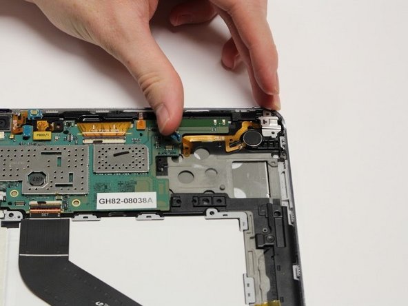

  3. Samsung Galaxy Note Pro 12.2 Audio Jack Replacement: crwdns2935265:03crwdnd2935265:01crwdnd2935265:01crwdne2935265:0
    • Remove the white cover over the audio jack with the plastic opening tool by pushing up on the black connecter.

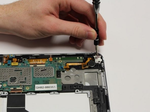

  4. Samsung Galaxy Note Pro 12.2 Audio Jack Replacement: crwdns2935265:04crwdnd2935265:01crwdnd2935265:02crwdne2935265:0 Samsung Galaxy Note Pro 12.2 Audio Jack Replacement: crwdns2935265:04crwdnd2935265:02crwdnd2935265:02crwdne2935265:0
    • Remove the two 3mm Phillips #00 screws over the silver cover.
    • The silver cover is attached to the whole audio jack; do not try to pull this away by itself.

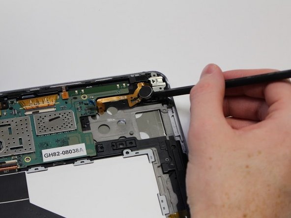

  5. Samsung Galaxy Note Pro 12.2 Audio Jack Replacement: crwdns2935265:05crwdnd2935265:01crwdnd2935265:02crwdne2935265:0 Samsung Galaxy Note Pro 12.2 Audio Jack Replacement: crwdns2935265:05crwdnd2935265:02crwdnd2935265:02crwdne2935265:0
    • Pop up the green connecter by gently pulling up.
  6. Samsung Galaxy Note Pro 12.2 Audio Jack Replacement: crwdns2935265:06crwdnd2935265:01crwdnd2935265:02crwdne2935265:0 Samsung Galaxy Note Pro 12.2 Audio Jack Replacement: crwdns2935265:06crwdnd2935265:02crwdnd2935265:02crwdne2935265:0
    • Pull up on the circular amp with the spudger tool to release it from the device.
  7. Samsung Galaxy Note Pro 12.2 Audio Jack Replacement: crwdns2935265:07crwdnd2935265:01crwdnd2935265:01crwdne2935265:0
    • Remove the whole audio jack by pulling gently up on the copper piece.
    • This component is extremely fragile.
