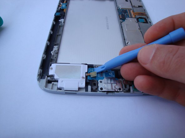

  8. Samsung Galaxy Note 8.0 USB Port Replacement: crwdns2935265:08crwdnd2935265:01crwdnd2935265:02crwdne2935265:0 Samsung Galaxy Note 8.0 USB Port Replacement: crwdns2935265:08crwdnd2935265:02crwdnd2935265:02crwdne2935265:0
    • Gently lift up the gold connector on the left side of the board.

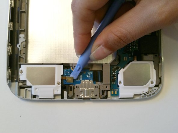

  9. Samsung Galaxy Note 8.0 USB Port Replacement: crwdns2935265:09crwdnd2935265:01crwdnd2935265:02crwdne2935265:0 Samsung Galaxy Note 8.0 USB Port Replacement: crwdns2935265:09crwdnd2935265:02crwdnd2935265:02crwdne2935265:0
    • Gently lift up the teal connector on the left side of the board.
