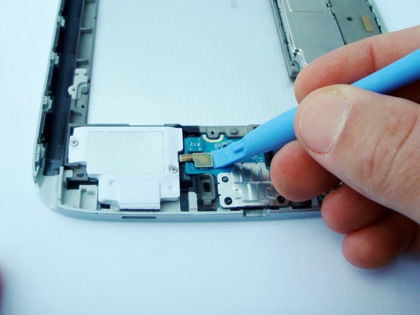

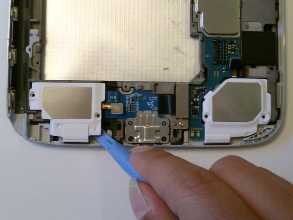

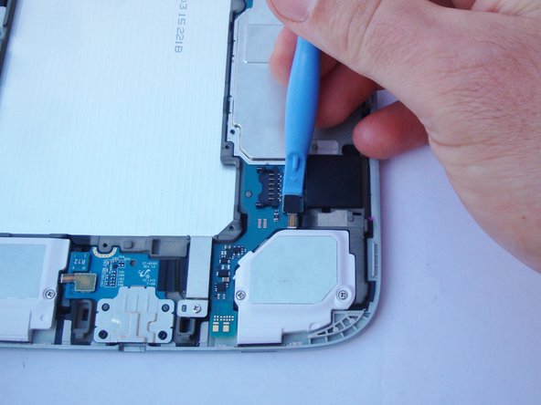

  7. Samsung Galaxy Note 8.0 Speaker Replacement, Speakers: crwdns2935265:07crwdnd2935265:01crwdnd2935265:03crwdne2935265:0 Samsung Galaxy Note 8.0 Speaker Replacement, Speakers: crwdns2935265:07crwdnd2935265:02crwdnd2935265:03crwdne2935265:0 Samsung Galaxy Note 8.0 Speaker Replacement, Speakers: crwdns2935265:07crwdnd2935265:03crwdnd2935265:03crwdne2935265:0
    • Gently pry up the connectors there is one per speaker
    • Do not yank the connector. If it does not disconnect easily use a plastic opening tool between the connector and the board to lift the connector away from the board.

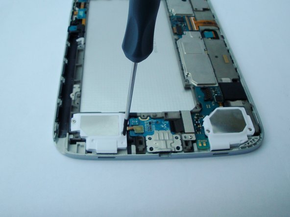

  8. Samsung Galaxy Note 8.0 Speaker Replacement: crwdns2935265:08crwdnd2935265:01crwdnd2935265:02crwdne2935265:0 Samsung Galaxy Note 8.0 Speaker Replacement: crwdns2935265:08crwdnd2935265:02crwdnd2935265:02crwdne2935265:0
    • For each speaker remove the two 3-mm Phillips head screws using a Phillips #00 screwdriver.
  9. Samsung Galaxy Note 8.0 Speaker Replacement: crwdns2935265:09crwdnd2935265:01crwdnd2935265:02crwdne2935265:0 Samsung Galaxy Note 8.0 Speaker Replacement: crwdns2935265:09crwdnd2935265:02crwdnd2935265:02crwdne2935265:0
    • Remove the speakers from their housing.
    • If difficult use a plastic opening tool to pry up.
