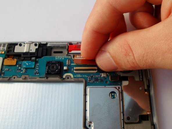

  7. Samsung Galaxy Note 8.0 Screen Assembly Replacement, Screen Digitizer and LCD: crwdns2935265:07crwdnd2935265:01crwdnd2935265:02crwdne2935265:0 Samsung Galaxy Note 8.0 Screen Assembly Replacement, Screen Digitizer and LCD: crwdns2935265:07crwdnd2935265:02crwdnd2935265:02crwdne2935265:0
    • Gently pull the tan part of the digitizer connector up.
    • Carefully slide the orange ribbon out from connector.

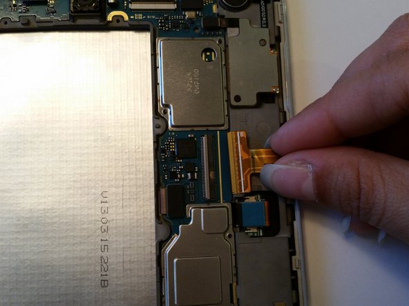

  12. Samsung Galaxy Note 8.0 Screen Assembly Replacement: crwdns2935265:012crwdnd2935265:01crwdnd2935265:01crwdne2935265:0
    • Slide your opening tool down the home button edge until the glue is free on this side.
  13. Samsung Galaxy Note 8.0 Screen Assembly Replacement: crwdns2935265:013crwdnd2935265:01crwdnd2935265:03crwdne2935265:0 Samsung Galaxy Note 8.0 Screen Assembly Replacement: crwdns2935265:013crwdnd2935265:02crwdnd2935265:03crwdne2935265:0 Samsung Galaxy Note 8.0 Screen Assembly Replacement: crwdns2935265:013crwdnd2935265:03crwdnd2935265:03crwdne2935265:0
    • Turn the tablet over and carefully press out the LCD panel from the back along the power button edge only. Push gently on the back of the LCD in the battery opening.
    • Disconnect ribbon that is connecting the screen assembly to the motherboard

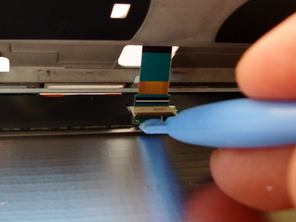

  14. Samsung Galaxy Note 8.0 Screen Assembly Replacement: crwdns2935265:014crwdnd2935265:01crwdnd2935265:01crwdne2935265:0
    • When inserting your opening tool on the side opposite the power button, avoid the screen cable located 7 cm from the top of the device.
    • Turn the tablet over and completely remove the LCD and screen assembly from the tablet by sliding a plastic opening tool down the final edge until the adhesive is free.
    • If you are replacing the screen by itself, continue to the next step. If you are replacing the screen digitizer only, simply follow the procedures in reverse to complete the replacement.

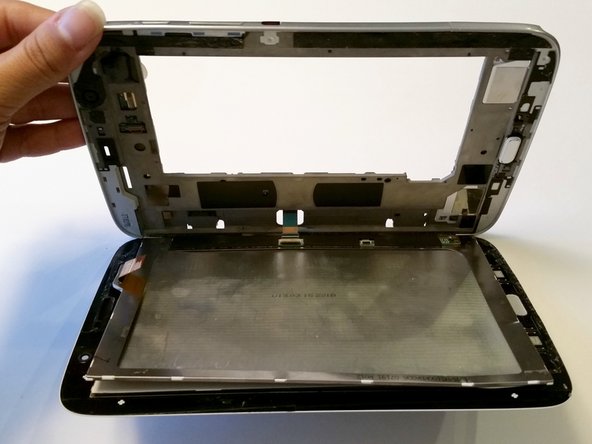

  15. Samsung Galaxy Note 8.0 Screen Assembly Replacement: crwdns2935265:015crwdnd2935265:01crwdnd2935265:01crwdne2935265:0
    • To separate the screen from the LCD you will need to heat the adhesive holding the two together.
    • Holding the heat gun, set to medium, approximately 6 inches from the screen, sweep from left to right as you move the heat gun across the tablet from top to bottom.
    • Continue heating the screen from top to bottom as you sweep from left to right for 5 minutes.
  16. Samsung Galaxy Note 8.0 Screen Assembly Replacement: crwdns2935265:016crwdnd2935265:01crwdnd2935265:01crwdne2935265:0
    • Find a plastic card you no longer need.
    • It will be covered in adhesive when you're done.
    • Slide the card between the screen and digitizer working around the edges toward the center.

For step 13, I ripped this motherboard connector trying to get the new lcd in. Anyone have any idea what I have actually damaged? And where I could find out how to fix it?
Henok Yared - crwdns2934203:0crwdne2934203:0
yes replacements are on ebay
