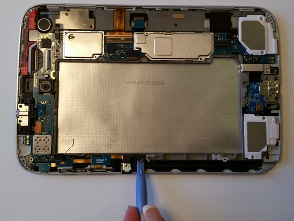

  4. Samsung Galaxy Note 8.0 Power/Volume Buttons Replacement, Battery: crwdns2935265:04crwdnd2935265:01crwdnd2935265:02crwdne2935265:0 Samsung Galaxy Note 8.0 Power/Volume Buttons Replacement, Battery: crwdns2935265:04crwdnd2935265:02crwdnd2935265:02crwdne2935265:0
    • Remove the 8 Phillips#00 3-mm screws holding the battery in place.
  5. Samsung Galaxy Note 8.0 Power/Volume Buttons Replacement: crwdns2935265:05crwdnd2935265:01crwdnd2935265:01crwdne2935265:0
    • Lift the top left corner of the battery up by the black tab.
  6. Samsung Galaxy Note 8.0 Power/Volume Buttons Replacement: crwdns2935265:06crwdnd2935265:01crwdnd2935265:01crwdne2935265:0
    • Gently grasp and lift up the white connector located at the bottom right corner of the battery. It is connected to the battery by two blue and two red wires.
    • Do not yank the connector by the wires. If it does not disconnect easily, slide a plastic opening tool between the white connector and the board to lift the connector away from the board.

My wife's Samsung galaxy note 8 would not turn on. She has had it for three years and we thought it should be scrapped. I searched for this problem on line and found this site. Ordered new on off kit on e-bay. Followed these instructions. Very straight forward. Took less than 30 minutes. Reassembled and returned tablet to wife, who is very happy. Hoping for a good meal tonight! Thanks very much Joel. Martin
