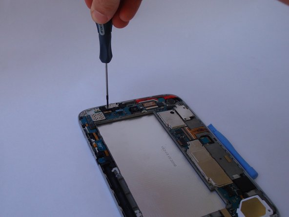

  7. Samsung Galaxy Note 8.0 Headphone Jack Replacement, Headphone Jack: crwdns2935265:07crwdnd2935265:01crwdnd2935265:02crwdne2935265:0 Samsung Galaxy Note 8.0 Headphone Jack Replacement, Headphone Jack: crwdns2935265:07crwdnd2935265:02crwdnd2935265:02crwdne2935265:0
    • Remove the two 4.5-mm black phillips head screws using a #00Phillips screwdriver.

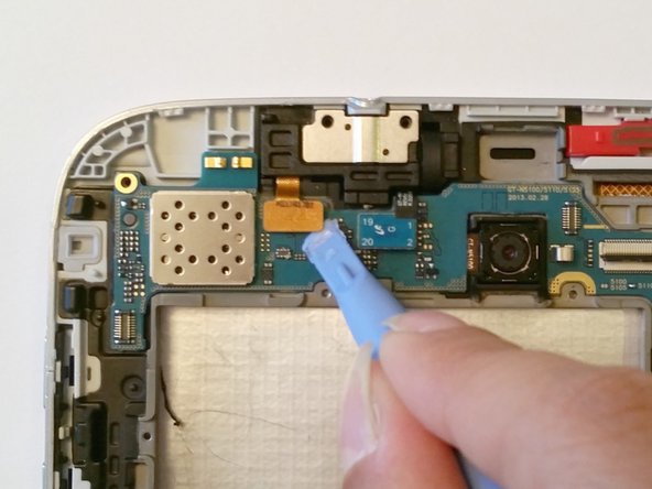

  8. Samsung Galaxy Note 8.0 Headphone Jack Replacement: crwdns2935265:08crwdnd2935265:01crwdnd2935265:02crwdne2935265:0 Samsung Galaxy Note 8.0 Headphone Jack Replacement: crwdns2935265:08crwdnd2935265:02crwdnd2935265:02crwdne2935265:0
    • Gently pry up the teal connector.
    • Do not yank the connector. If it does not disconnect easily use a plastic opening tool between the connector and the board to lift the connector away from the board.
  9. Samsung Galaxy Note 8.0 Headphone Jack Replacement: crwdns2935265:09crwdnd2935265:01crwdnd2935265:02crwdne2935265:0 Samsung Galaxy Note 8.0 Headphone Jack Replacement: crwdns2935265:09crwdnd2935265:02crwdnd2935265:02crwdne2935265:0
    • Gently pry up the gold connector.
