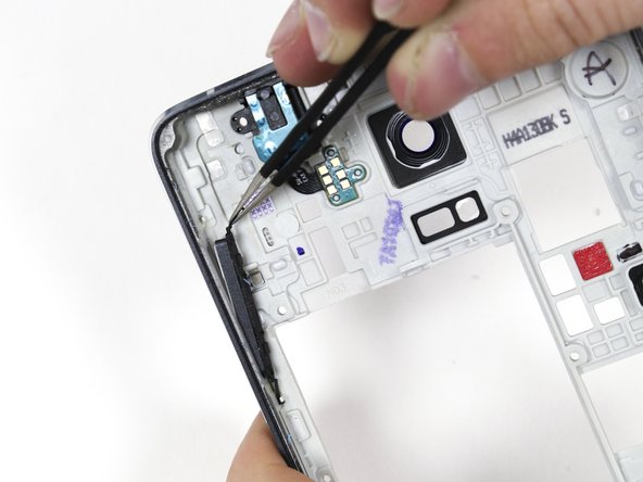

  8. Samsung Galaxy Note 4 Volume Buttons Replacement, Volume Buttons: crwdns2935265:08crwdnd2935265:01crwdnd2935265:02crwdne2935265:0 Samsung Galaxy Note 4 Volume Buttons Replacement, Volume Buttons: crwdns2935265:08crwdnd2935265:02crwdnd2935265:02crwdne2935265:0
    • Use a set of tweezers to free the volume buttons from the midframe.
