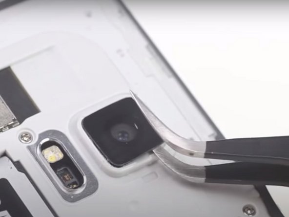

  2. Samsung Galaxy Note 4 Rear Facing Camera Lens Replacement, Rear Facing Camera Lens: crwdns2935265:02crwdnd2935265:01crwdnd2935265:03crwdne2935265:0 Samsung Galaxy Note 4 Rear Facing Camera Lens Replacement, Rear Facing Camera Lens: crwdns2935265:02crwdnd2935265:02crwdnd2935265:03crwdne2935265:0 Samsung Galaxy Note 4 Rear Facing Camera Lens Replacement, Rear Facing Camera Lens: crwdns2935265:02crwdnd2935265:03crwdnd2935265:03crwdne2935265:0
    • Use a pair of tweezers to pry off the rear-facing camera ring.
    • You may need to use the tweezers to run along the sides of the camera ring to loosen it.
  3. Samsung Galaxy Note 4 Rear Facing Camera Lens Replacement: crwdns2935265:03crwdnd2935265:01crwdnd2935265:02crwdne2935265:0 Samsung Galaxy Note 4 Rear Facing Camera Lens Replacement: crwdns2935265:03crwdnd2935265:02crwdnd2935265:02crwdne2935265:0
    • Use a pair of tweezers to peel off the camera ring adhesive.
  4. Samsung Galaxy Note 4 Rear Facing Camera Lens Replacement: crwdns2935265:04crwdnd2935265:01crwdnd2935265:03crwdne2935265:0 Samsung Galaxy Note 4 Rear Facing Camera Lens Replacement: crwdns2935265:04crwdnd2935265:02crwdnd2935265:03crwdne2935265:0 Samsung Galaxy Note 4 Rear Facing Camera Lens Replacement: crwdns2935265:04crwdnd2935265:03crwdnd2935265:03crwdne2935265:0
    • Gently slide one tip of a pair of tweezers underneath the rear-facing camera lens.
    • Pry upwards with the tweezers and remove the camera lens.
