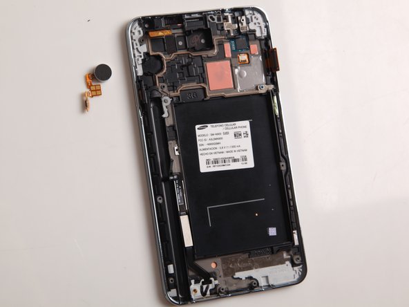

  10. Samsung Galaxy Note 3 Teardown: crwdns2935265:010crwdnd2935265:01crwdnd2935265:02crwdne2935265:0 Samsung Galaxy Note 3 Teardown: crwdns2935265:010crwdnd2935265:02crwdnd2935265:02crwdne2935265:0
    • Use screwdriver to pry out the vibrating motor. Please be noted the motor is adhered to the front chassis and connected with the power button. Please lift it up carefully to avoid damaging the power button cable.
  11. Samsung Galaxy Note 3 Teardown: crwdns2935265:011crwdnd2935265:01crwdnd2935265:01crwdne2935265:0
    • The Samsung Galaxy Note 3 teardown is complete.
