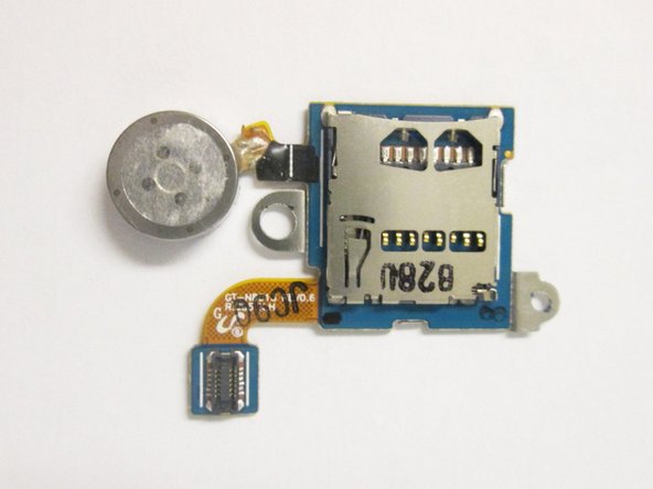

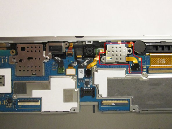

  3. Samsung Galaxy Note 10.1 microSD Port Replacement, Removing the microSD Port: crwdns2935265:03crwdnd2935265:01crwdnd2935265:03crwdne2935265:0 Samsung Galaxy Note 10.1 microSD Port Replacement, Removing the microSD Port: crwdns2935265:03crwdnd2935265:02crwdnd2935265:03crwdne2935265:0 Samsung Galaxy Note 10.1 microSD Port Replacement, Removing the microSD Port: crwdns2935265:03crwdnd2935265:03crwdnd2935265:03crwdne2935265:0
    • Unscrew the two 2 mm screws indicated by the red circles with the #00 Philips Screwdriver.
    • Starting with the black motherboard connector, remove the module indicated by the red box in the second picture.
    • Replace the microSD port with a similar model.
