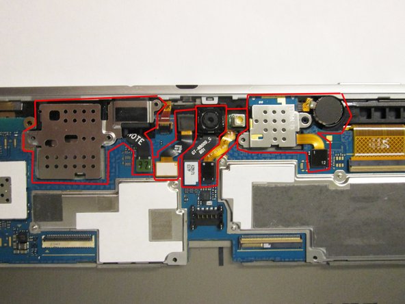

  5. Samsung Galaxy Note 10.1 Speaker Replacement, Removing the Components Around the Motherboard: crwdns2935265:05crwdnd2935265:01crwdnd2935265:03crwdne2935265:0 Samsung Galaxy Note 10.1 Speaker Replacement, Removing the Components Around the Motherboard: crwdns2935265:05crwdnd2935265:02crwdnd2935265:03crwdne2935265:0 Samsung Galaxy Note 10.1 Speaker Replacement, Removing the Components Around the Motherboard: crwdns2935265:05crwdnd2935265:03crwdnd2935265:03crwdne2935265:0
    • From the first photo:
    • Remove all the components marked by yellow circles
    • Unscrew all the 2 and 3 mm screws marked by the red circles with the #00 Philips screwdriver.
    • From the second photo:
    • Starting with the motherboard connectors, remove all the components marked in red.
    • Please place all components removed after this point in a static-free area or in anti-static bags.
    • Please note that you can only remove the ribbon attached to the headphone jack and the metal covering it on the far left. Do not attempt to remove the whole piece at this time.

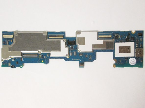

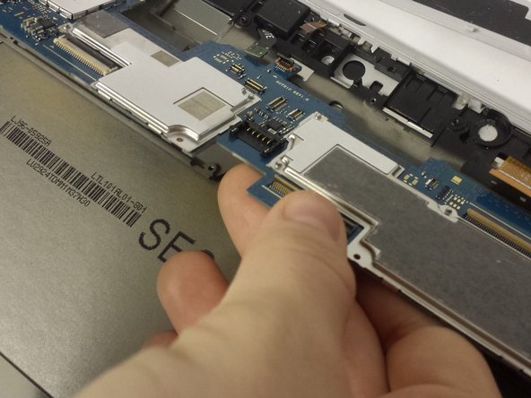

  6. Samsung Galaxy Note 10.1 Speaker Replacement, Removing the Motherboard: crwdns2935265:06crwdnd2935265:01crwdnd2935265:03crwdne2935265:0 Samsung Galaxy Note 10.1 Speaker Replacement, Removing the Motherboard: crwdns2935265:06crwdnd2935265:02crwdnd2935265:03crwdne2935265:0 Samsung Galaxy Note 10.1 Speaker Replacement, Removing the Motherboard: crwdns2935265:06crwdnd2935265:03crwdnd2935265:03crwdne2935265:0
    • Once you have removed all the components connected to the motherboard, gently lift up on the area surrounding the green box and remove your motherboard.
    • Please place the motherboard in a static-free area or in anti-static bags.

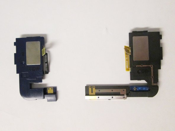

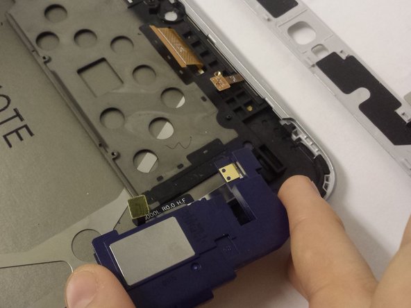

  7. Samsung Galaxy Note 10.1 Speaker Replacement, Remove the loudspeaker modules: crwdns2935265:07crwdnd2935265:01crwdnd2935265:03crwdne2935265:0 Samsung Galaxy Note 10.1 Speaker Replacement, Remove the loudspeaker modules: crwdns2935265:07crwdnd2935265:02crwdnd2935265:03crwdne2935265:0 Samsung Galaxy Note 10.1 Speaker Replacement, Remove the loudspeaker modules: crwdns2935265:07crwdnd2935265:03crwdnd2935265:03crwdne2935265:0
    • Apply pressure to the locations boxed in red to remove the loudspeaker modules.
    • These are your loudspeaker modules, replace with the new parts

In Step 7, mention that you should use the plastic tools to pop the speakers out of the device.
