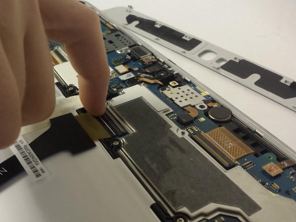

    3. Samsung Galaxy Note 10.1 LCD Replacement, Removing components covering battery: crwdns2935265:03crwdnd2935265:01crwdnd2935265:03crwdne2935265:0 Samsung Galaxy Note 10.1 LCD Replacement, Removing components covering battery: crwdns2935265:03crwdnd2935265:02crwdnd2935265:03crwdne2935265:0 Samsung Galaxy Note 10.1 LCD Replacement, Removing components covering battery: crwdns2935265:03crwdnd2935265:03crwdnd2935265:03crwdne2935265:0
      • Carefully remove all of the ribbons that connect over the battery from the locations indicated by the yellow circles.

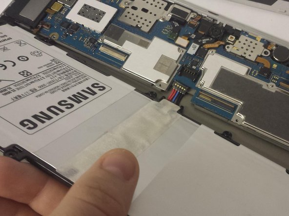

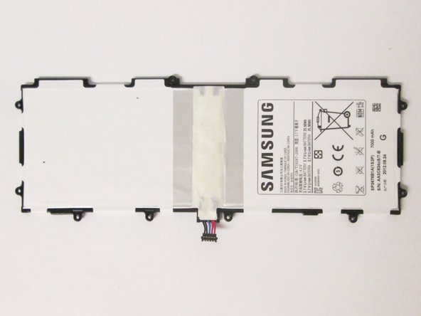

    4. Samsung Galaxy Note 10.1 LCD Replacement, Removing the Battery: crwdns2935265:04crwdnd2935265:01crwdnd2935265:03crwdne2935265:0 Samsung Galaxy Note 10.1 LCD Replacement, Removing the Battery: crwdns2935265:04crwdnd2935265:02crwdnd2935265:03crwdne2935265:0 Samsung Galaxy Note 10.1 LCD Replacement, Removing the Battery: crwdns2935265:04crwdnd2935265:03crwdnd2935265:03crwdne2935265:0
      • Remove all of the 3 mm screws indicated by a red circle with the #00 Philips screwdriver.
      • Disconnect the battery from the location indicated by a yellow circle
      • Now you may remove the battery.

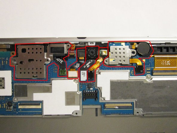

    5. Samsung Galaxy Note 10.1 LCD Replacement, Removing the Components Around the Motherboard: crwdns2935265:05crwdnd2935265:01crwdnd2935265:03crwdne2935265:0 Samsung Galaxy Note 10.1 LCD Replacement, Removing the Components Around the Motherboard: crwdns2935265:05crwdnd2935265:02crwdnd2935265:03crwdne2935265:0 Samsung Galaxy Note 10.1 LCD Replacement, Removing the Components Around the Motherboard: crwdns2935265:05crwdnd2935265:03crwdnd2935265:03crwdne2935265:0
      • From the first photo:
      • Remove all the components marked by yellow circles
      • Unscrew all the 3 mm and 2 mm screws marked by the red circles with the #00 Philips screwdriver.
      • From the second photo:
      • Starting with the motherboard connectors, remove all the components marked in red.
      • Please place all components removed after this point in a static-free area or in anti-static bags.
      • Please note that you can only remove the ribbon attached to the headphone jack and the metal covering it on the far left. Do not attempt to remove the whole piece at this time.

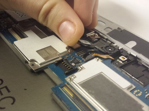

    6. Samsung Galaxy Note 10.1 LCD Replacement, Removing the Motherboard: crwdns2935265:06crwdnd2935265:01crwdnd2935265:03crwdne2935265:0 Samsung Galaxy Note 10.1 LCD Replacement, Removing the Motherboard: crwdns2935265:06crwdnd2935265:02crwdnd2935265:03crwdne2935265:0 Samsung Galaxy Note 10.1 LCD Replacement, Removing the Motherboard: crwdns2935265:06crwdnd2935265:03crwdnd2935265:03crwdne2935265:0
      • Once you have removed all the components connected to the motherboard, gently lift up on the area surrounding the green box and remove your motherboard.
      • Please place the motherboard in a static-free area or in anti-static bags.

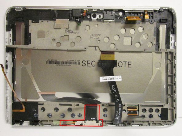

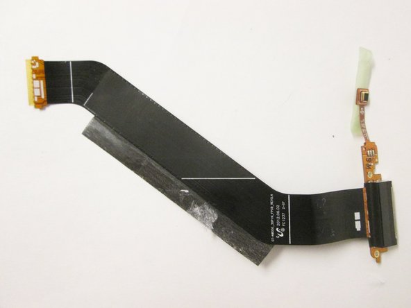

    8. Samsung Galaxy Note 10.1 LCD Replacement, Removing the Charging Port: crwdns2935265:08crwdnd2935265:01crwdnd2935265:03crwdne2935265:0 Samsung Galaxy Note 10.1 LCD Replacement, Removing the Charging Port: crwdns2935265:08crwdnd2935265:02crwdnd2935265:03crwdne2935265:0 Samsung Galaxy Note 10.1 LCD Replacement, Removing the Charging Port: crwdns2935265:08crwdnd2935265:03crwdnd2935265:03crwdne2935265:0
      • Unscrew the 2 mm screws marked by red circles with the #00 Philips screwdriver.
      • Be sure to lift the tape marked by the yellow circle from the frame.
      • Gently pry the ribbon from the frame and lift the charging port from the frame.
      • Please place the charging port in a static-free area or in anti-static bags.
